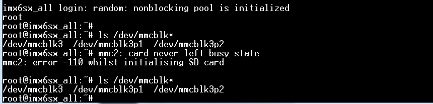

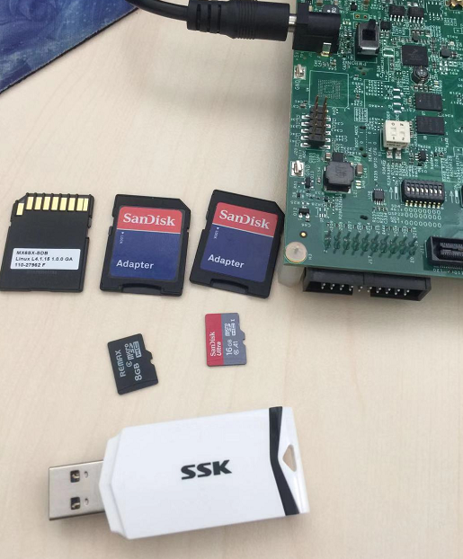

Today I did more test about the SD card. I am using  microSD card with SD card adapter.
After boot the board with the out-of-box 8GB SanDisk SD card from EVB SD4 slot, insert the microSD card with adapter into SD3 slot, log as below:
issue log:
root@imx6sx_all:~# mmc2: card never left busy state
mmc2: error -110 whilst initialising SD card
Seems the microSD card cannot be detected by the board.

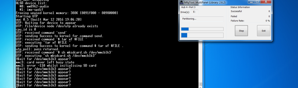

I also tested by using MFG tool:
1. Remove all SD card.
2. Power on the board, then insert the microSD card with adapter into SD4 slot.
3. Run the mfgtool2-yocto-mx-sabresd-sdcard-sd4.vbs script file, log as below:
The log shows polling init sd card failed and polling the sd card continuously.
I have tested 2 micro SD cards with same issue. BUT, the micro SD cards with adapter can be used on my windows and Ubuntu Host.
Would you please help to check:
1. Would you please explain the details about the log issue?
2.Does the  MCIMX6SX-SDB's SD slot cannot work with microSD? what is the reason, the SD controller driver ability or EVB layout issue?

lesu
Hi igor,
Today i tried to use en SD card instead of TF card with adapter, use same method and can boot the board.
Although feel confused but this case can be closed.
