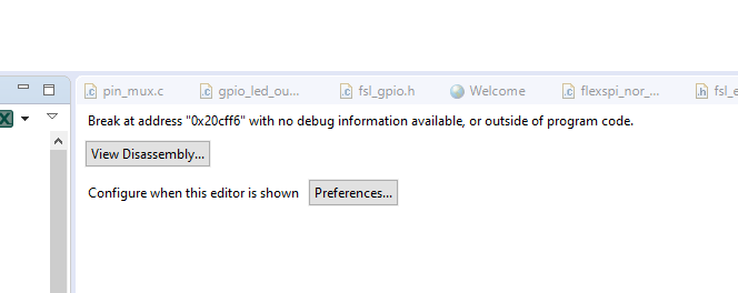

I am trying to debug my code using my new custom board that has iMX RT1062 MCU on it and a 16 MB flash on it: IS25LP128F-JBLE.
I verified that my boot configuration is correct. I set it internal boot. However, when I run my debugger, I get the error below:
Break at address "0xdeadbeee" with no debug information available, or outside of program code.
I am using Segger debugger. Can any one tell  me what this error is all about?

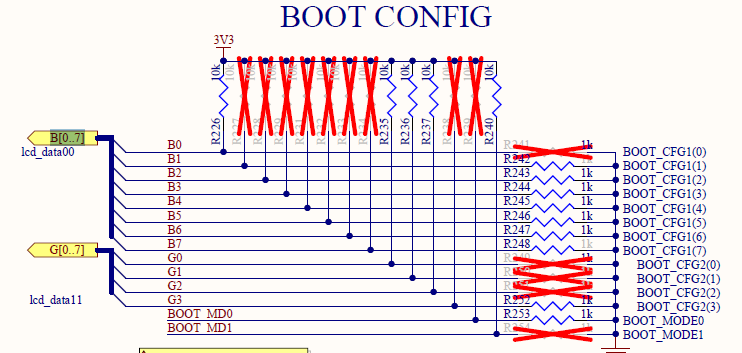

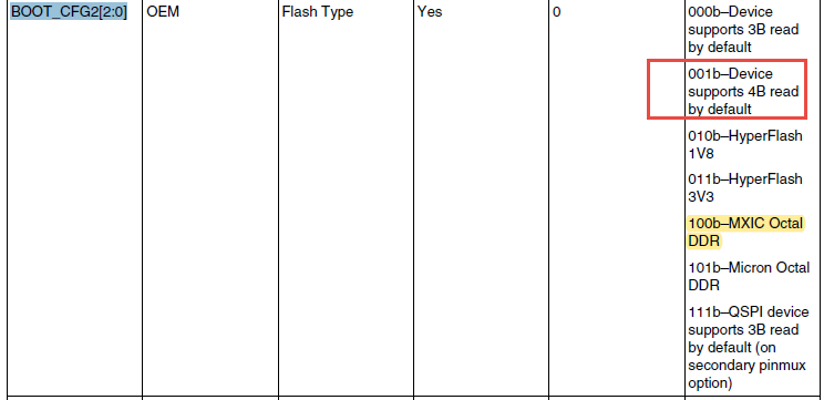

  You give me the key clue: I just want to let you know that I am using these pins for my Flexspi interface. These are not the same as in the iMX RT1060-evk dev board.
Please share your schematic with me, I need to check the detail pins, I also need to check whether your hardware is really supported by the ROM bootloader.
  If you want to boot correctly, you must refer to the RT1060 RM, Table 8-1. ROM Bootloader Peripheral PinMux
Or ,do you use the secondary pinmux option?
Please share your schematic.
This is very important to the problem solving, if you are using the secondary pinmux, you can't use the JLINK debug it, because the JLINK programmer algorithm can't support it, the JLINK programmer algorithm just support the primary mode. Then you just can try the MCUBootUtility to download the code, if you are really using the secondary pimux option, you also make sure your primary didn't connect the useful flash.

    Sorry, I think you are using the primary flexspi in the previous time.
    If you are using the secondary pinmux, you still lneed to set the BOOT_CFG2[2:0] to 111, not 000, 000 is used for the primary flexspi.

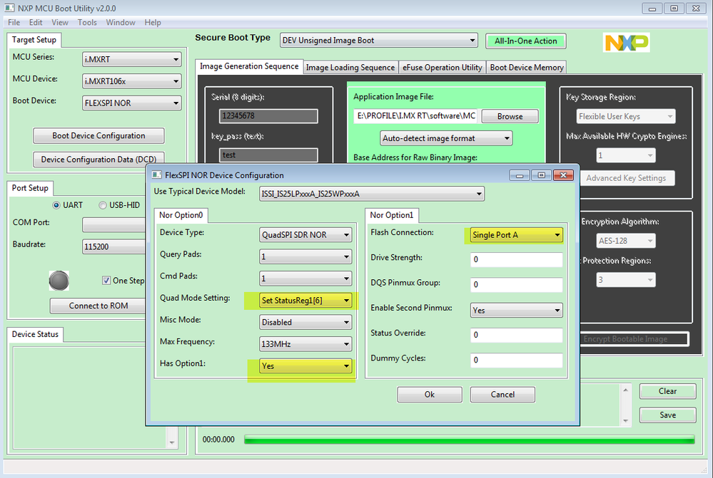

    Do you try the MCUBootUtility tool in the serial downloader mode, whether it works or not? Then your code don't need to configure the pinmux.c.

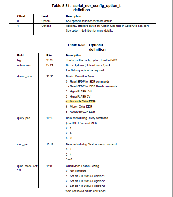

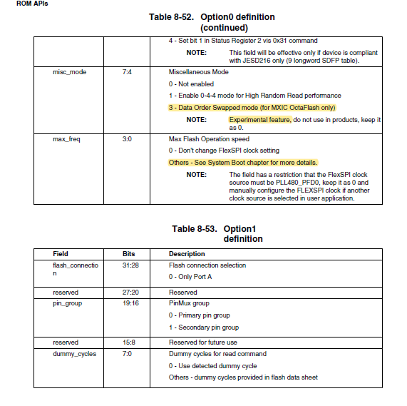

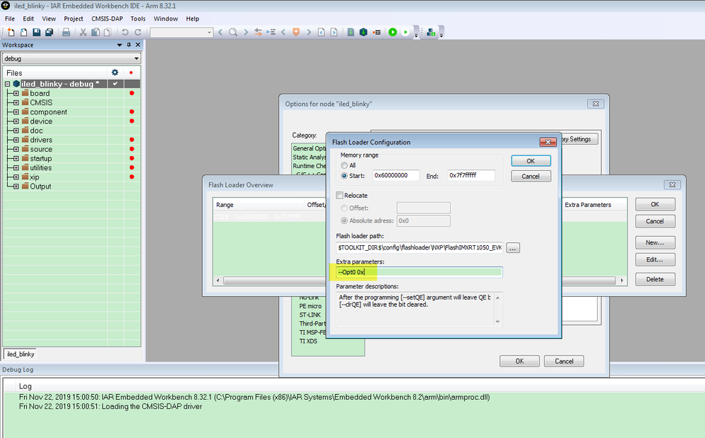

If you are using the IAR download the normal app, you also don't need to configure the pinmux.c for the flexspi.
But you need to modify the option0 and option1 in the .board
pastedImage_165.pngthe parameters can be:
"--Qspi"      - QuadSPI NOR - Quad SDR Read (same if no arg is used)
"--QspiDDR"   - QuadSPI NOR - Quad DDR Read
"--Hyper1V8"  - HyperFLASH 1V8
"--Hyper3V0"  - HyperFLASH 3V0
"--MxicOpiDDR"-  MXIC OPI DDR (OPI DDR enabled by default)
"--McrnOct"   -  Micron Octal DDR
"--McrnOpi"   -  Micron OPI DDR
"--McrnOpiDDR"- Micron OPI DDR (DDR read enabled by default):
"--AdstOpi"   - Adesto OPI DDR
"--Opt0 0x..."- set Option0 hex value
"--Opt1 0x..."- set Option1 hex value
You can try it.

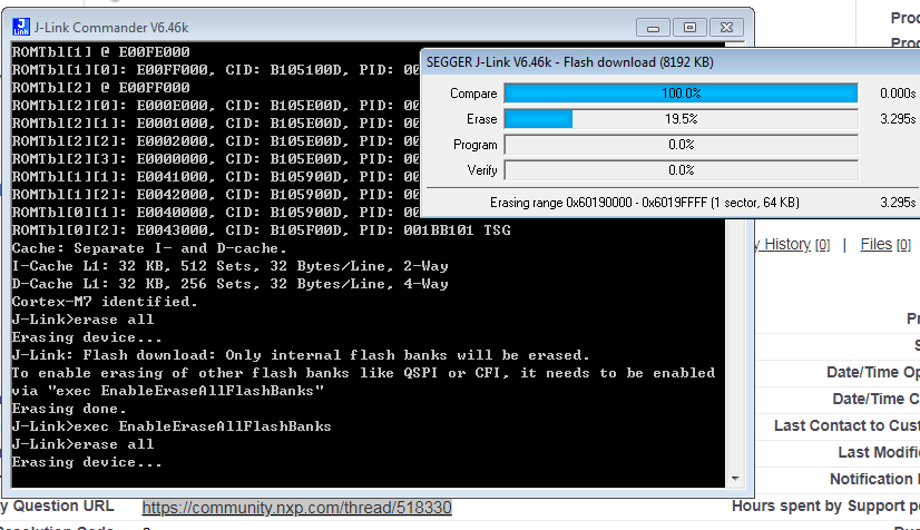

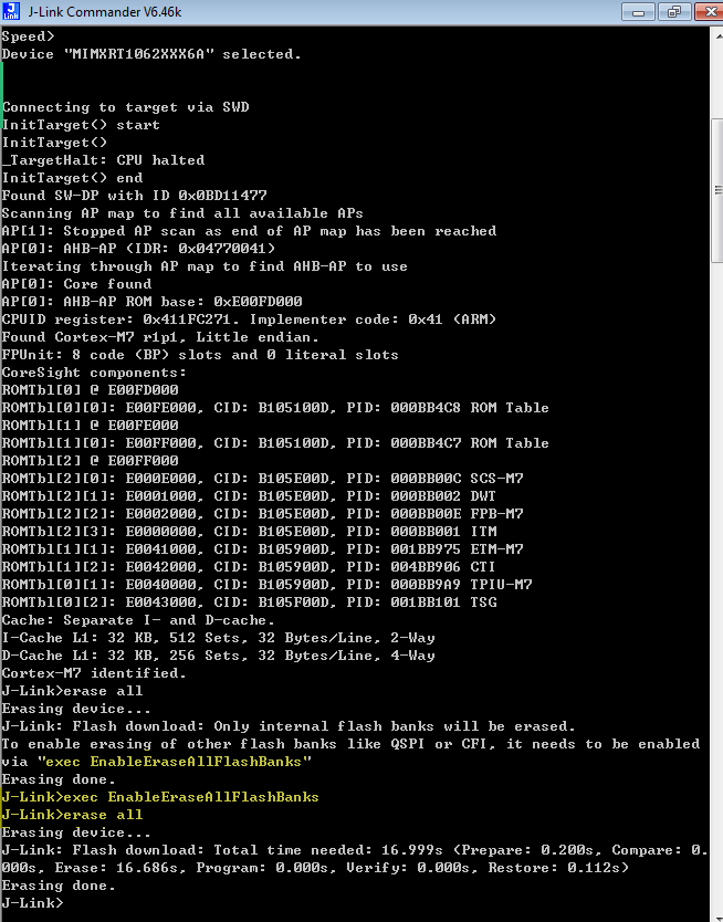

3. JLINK erase,
You can follow my following steps, the JLINK can erase the external QSPI flash:
4. BOOT_CFG2[2:0]
   No, you need to select 000, not the 111.
Please note, 111 qspi is used for the secondary pinmux option.

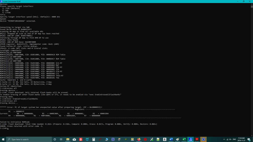

farid_mabrouk

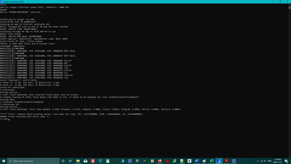

Hi Kerry! please see the messages I get when I try to do flash erase all
11,275 Views
farid_mabrouk
11,275 Views
farid_mabrouk
Now my BOOT_CFG1[0-7] are set to 0. and BOOT_CFG2[0-3] are also set to zero. my Boot0 is set to 0 and BOOT1 is set to 1. I still cannot erase or program the QSPI flash.
also please see the test results I got with jlink commander:
