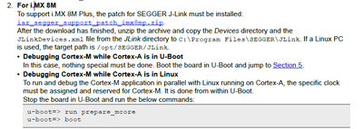

2,154 Views
danielchen
HI @JohnE :
To support i.MX 8M Plus, the patch for SEGGER J-LINK must be installed.
Please refer to AN14120 for more details.
AN14120: Debugging Cortex-M with VS Code on i.MX 8M, i.MX 8ULP, and i.MX 9 | NXP Semiconductors
2,145 Views

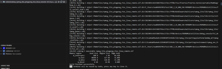

2,133 Views
danielchen
Hi @JohnE :
I did a quick check on my side with SDK 2.16.  It works on my side.
Please refer to below picture.
2,119 Views
JohnE
I chose SDK v2.16.100 because I thought it would be newer.
When I try SDK v2.16.000 the project is imported correctly.
Anyway, now I can see if it solves my problem.
John
