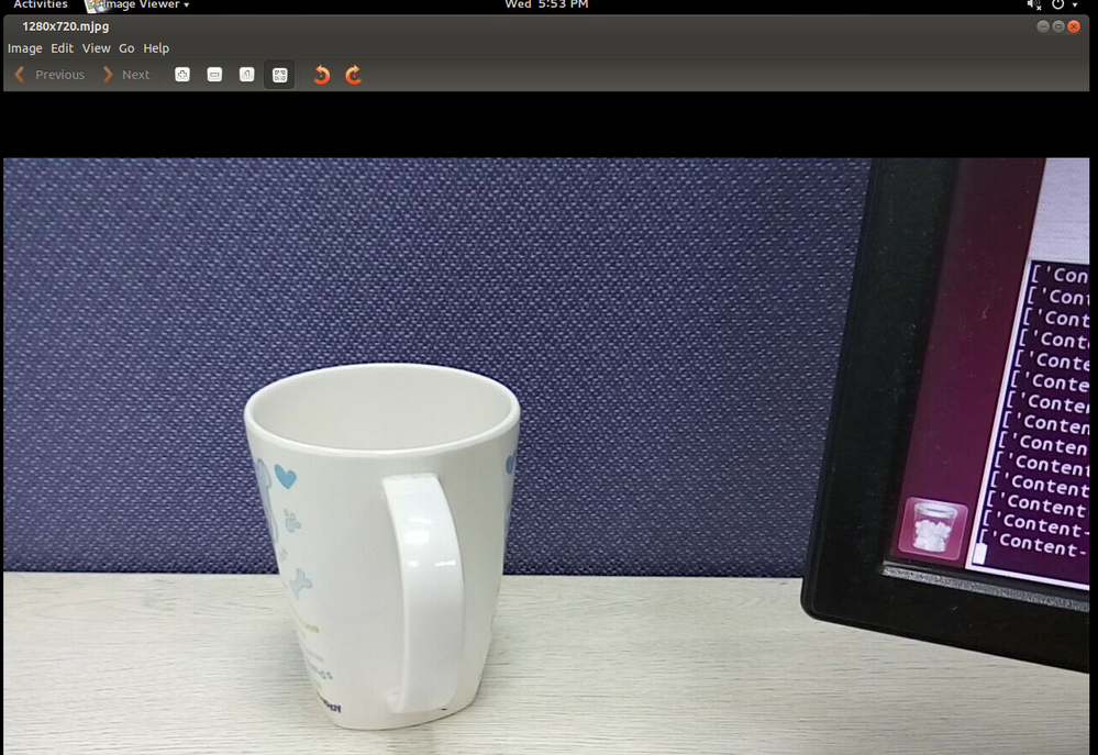

gfine
Hi Yanfeng,
I managed to get access to your file.
I tried another player (Ubuntu 14.04 and Image viewer)  and it shows a coffee cup sitting on a desk (see attached capture) .  So it was encoded properly.
We may want to look at the capabilities of whatever player you used to decode. You said "test_dec_arm_elinux" Correct?
I tried gplay and it seems to display properly on a 6Q test baord I have.
Cheers,
Glen
