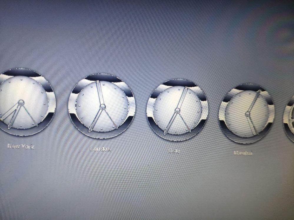

Hello all!
I want to create correct device tree for Tianma nl10276bc13-01c with BSP for imx6qp (TQMa6x platform) .
I've built OS image and currently try to use imx6qdl-mba6-lvds-tm070jvhg33.dtsi (in attach) from kernel-4.14, which is compatible with other Tianma display:

But my display has different characteristics (other size, other resolution...), so I see some poor quality when run some qt-examples (see examples below).
I cannot get what's the problem, is it related to wrong resolution or wrong color depth? And what should I change in device tree for correct display working?

I've found wrong option in configuration after consulting with a electronics specialist, it was 'data-mapping', the right option for color map had to be 'jeida'.
Anyway, thanks.

igorpadykov
Hi Maksim
for custom lcd timings one can look at documentation:
fsl,imx-fb.txt - Documentation/devicetree/bindings/video/fsl,imx-fb.txt - Linux source code (v4.0) -...
Adding a custom display
https://community.nxp.com/thread/355690
igor
3,006 次查看
adrocohen
Thank you for such useful links, I will try to get into it and try to build my device tree.
So, bad image quality is related to wrong timings, right?
