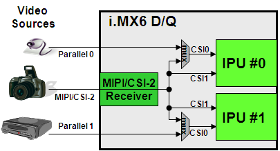

Does anyone have any experience connecting an Aptina MT9M024 to a Freescale SABRE platform for smart devices dev board? (or something similar) How do you do it hardware and software wide?  Is it more or less plug & play with the MIPI or DVP Camera  Connectors?

Basically the i.MX6 has two different options to interface a camera device,  this is using the  Parallel Interface, an MIPI Interface this is accomplish using the CSI port. Here is an image on how to connect.
Jaime
