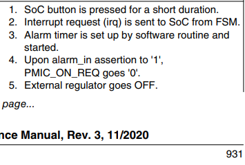

AMBh
Yes you were right, I can turn OFF and ON the board.
But now if as per the below screenshot
Can we check the irq status in user space which was sent to SOC by FSM after button press?
If yes then how?
