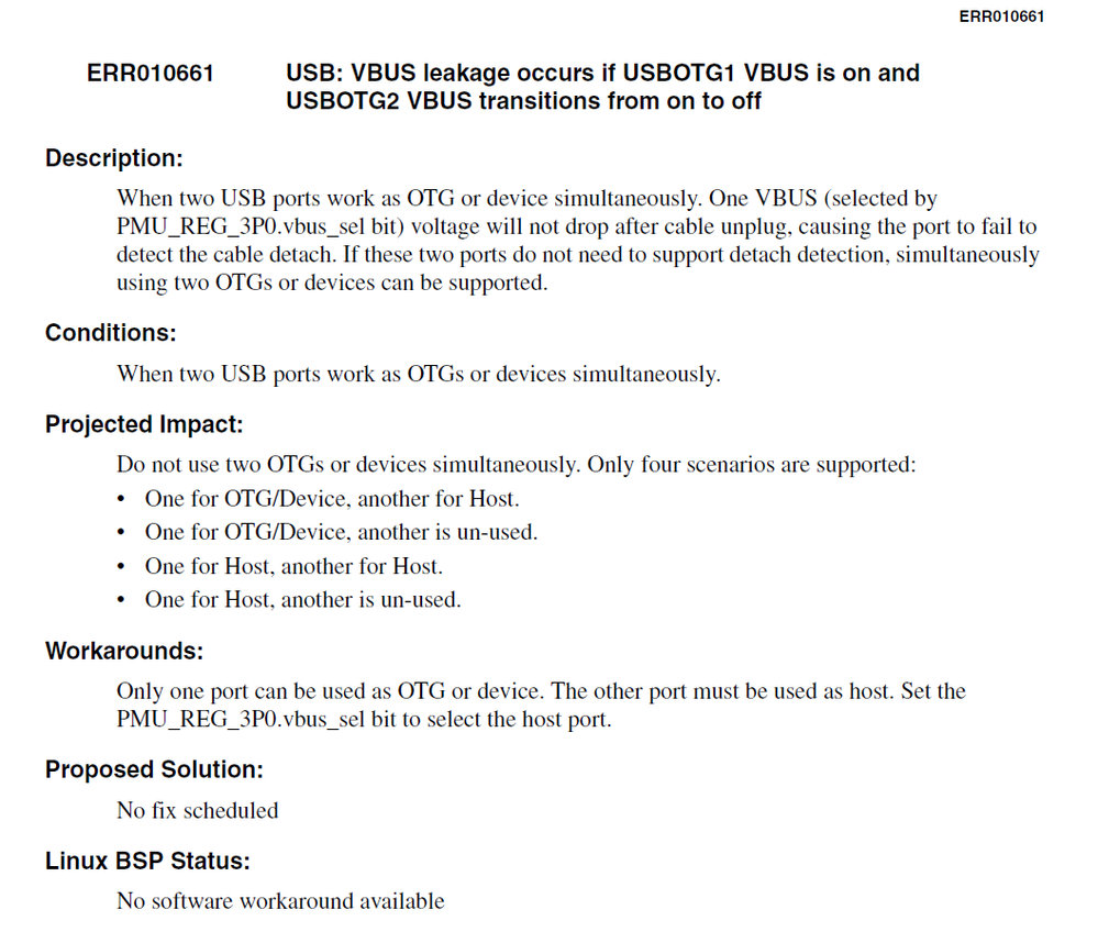

I am looking for the guidance/document for the configuring USB OTG2 port in the peripheral mode. By default it is configured in Host mode.
I made changes in the eval board imx6ul-14x14-evk.dts as below.
&usbotg2 {
dr_mode = "peripheral";
disable-over-current;
status = "okay";
What else required to configure second USB port in peripheral mode?
Secondly, what should I configure to tell gadget examples(g_serial and g_hid) to link with this second USB port?

Thanks TIC Weidong sun for the response.
As mentioned in errata sheet, the board can support two devices simultaneously if support for the cable detach is not required.
I would like to know impact of this limitations. If limitations are acceptable then I would like to refer such implementation. Could you please provide us such information.

Hello Krunal,
   For 2 USB OTG ports on i.MX6UL EVK, only one of them can be configured as OTG mode, the other must be Host mode. see Errata of i.MX6UL:
On i.mx6ul EVK, USB OTG1 is configured as Dual role mode, so USB OTG2 must work at USB Host Mode.
