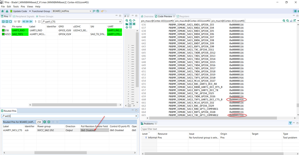

Hi NXP,
we have a question about the Config Tools for i.MX8, in the generated dts file we can see that some Pad Control Register values have their Reserved bit fields set:
for example: MX8MM_IOMUXC_SAI2_TXFS_UART1_DCE_CTS_B 0x00001816
  1. Is this a bug in the Config Tools?
  2. Can the reserved bit value be ignored and not being set? For example:
using:
MX8MM_IOMUXC_SAI2_TXFS_UART1_DCE_CTS_B   0x16
instead of:
Regards.
      No, this is not.
      For reserve bit, whether you set it, it is useless.
   >>Can the reserved bit value be ignored and not being set?
    Yes , it can.
     you don't need to configure it.
