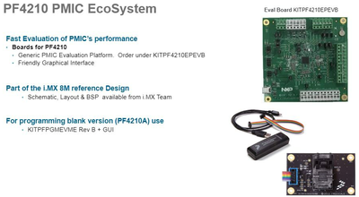

Hello everyone,
I would appreciate it if anyone who has experience with this could provide some information on whether or not the PF4210 can be programmed with the KITPF0100SKTEVBE programmer. If it is not compatible, I would also be interested in learning about any alternative programming solutions that could work with the PF4210.
Thank you in advance for your help and insights.
Alexandre Yos
2 返答(返信)
829件の閲覧回数
ErikaC
For programming PF4210 please use KITPFPGMEVME PF Series Programmer.
Regards.
828件の閲覧回数
Chockichoc
Thanks !
