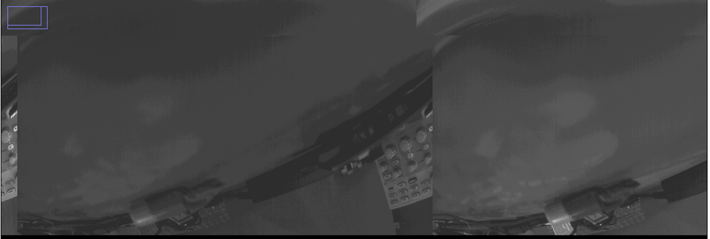

I run below command to capture one frame and its creating frame.raw file
v4l2-ctl --device /dev/video0 --set-fmt-video=width=2688,height=1520,pixelformat=BG10
v4l2-ctl --device /dev/video0 --stream-mmap --stream-to=frame.raw --stream-count=1
Once done I am able to convert that frame.raw file to png and image with black and white is there.

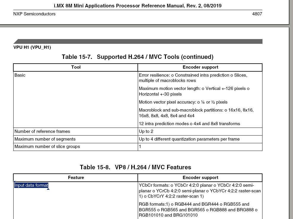

igorpadykov
Hi Devendra
this input data format is not supported by i.MX8M Mini vpu, as seen
from log " vpuenc_h264-0 can't handle caps video/x-raw" and description
i.MX8M Mini Reference Manual for vpu encoder capabilities:
and one can follow suggestions provided on
OV5647 raw camera : lower half image is black (blanking ?)
igor

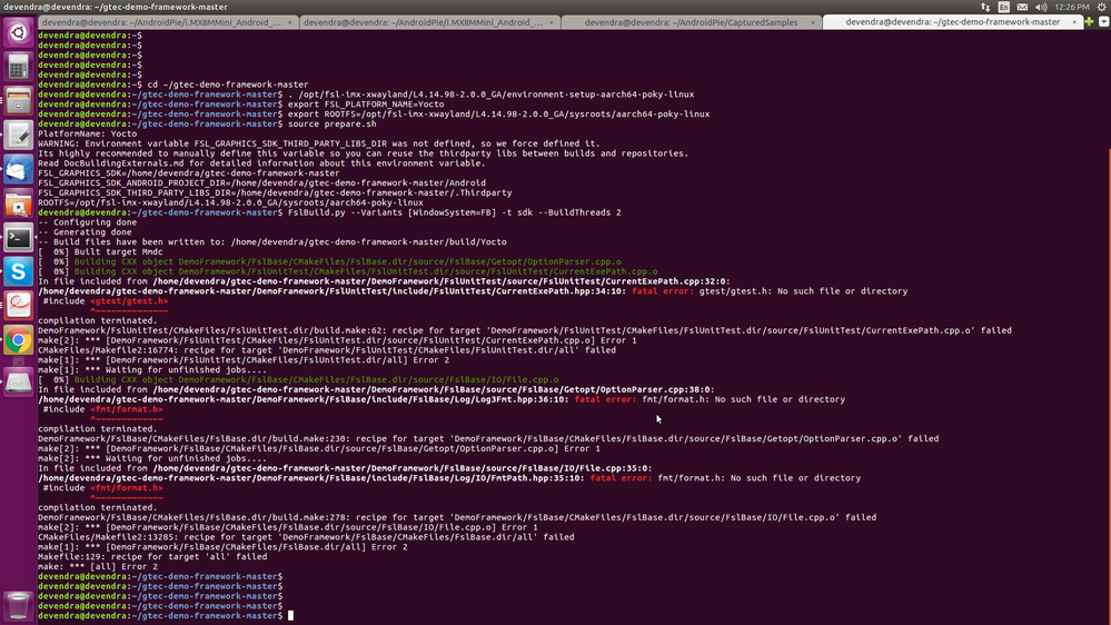

I am able to download the gtec-demo-framework source code. For building I tried below methods:
I followed the methods mentioned in below link:
Building using a prebuild Yocto SDK
gtec-demo-framework/Setup_guide_yocto.md at master · NXPmicro/gtec-demo-framework · GitHub
For i.MX8M Mini I build the SDK with bitbake command
$bitbake meta-toolchain
$cd tmp/deploy/sdk
$./fsl-imx-xwayland-glibc-x86_64-meta-toolchain-aarch64-toolchain-L4.14.98-2.0.0_GA.sh
And installed in "/opt/fsl-imx-xwayland/L4.14.98-2.0.0_GA".
Then follow the method mentioned in above link for environment setup and followed the "Using the demo framework" steps:
cd ~/gtec-demo-framework-master
. /opt/fsl-imx-xwayland/L4.14.98-2.0.0_GA/environment-setup-aarch64-poky-linux
export FSL_PLATFORM_NAME=Yocto
export ROOTFS=/opt/fsl-imx-xwayland/L4.14.98-2.0.0_GA/sysroots/aarch64-poky-linux
source prepare.sh
FslBuild.py --Variants [WindowSystem=FB] -t sdk --BuildThreads 2
Then I am getting error like below:
Anything I missed here? Is there any proper document is there to build ?
Thanks and Regards,
Devendra

Below is the steps I followed:
DISTRO=fsl-imx-xwayland MACHINE=imx8mm_iwg34m source fsl-setup-release.sh -b build_imx8mm_gtec -e wayland
In conf/local.conf I added as below
CORE_IMAGE_EXTRA_INSTALL += " assimp devil gtest fmt"
bitbake fsl-image-gui
bitbake meta-ide-support
mkdir  ~/unpacked-rootfs/build-wayland_test
runqemu-extract-sdk tmp/deploy/images/imx8mm_iwg34m/fsl-image-gui-imx8mm_iwg34m.tar.bz2 ~/unpacked-rootfs/build-wayland_test
pushd /home/devendra/AndroidPie/i.MX8MMini_Android_Patch_Draft/LINUX_BSP/iwg34-release-bsp/build_imx8mm/tmp
source environment-setup-aarch64-poky-linux
export ROOTFS=/home/devendra/unpacked-rootfs/build-wayland_test
popd
source prepare.sh
FslBuild.py --Variants [WindowSystem=Wayland] -t sdk --BuildThreads 2
Now also same error I am getting as in previous.

devendradevadig
With this application (http://www.easy2convert.com/dlnaaak/raw2jpg.exe ), when I converted (frame.raw) file I captured through camera to JPG its coming like this:
