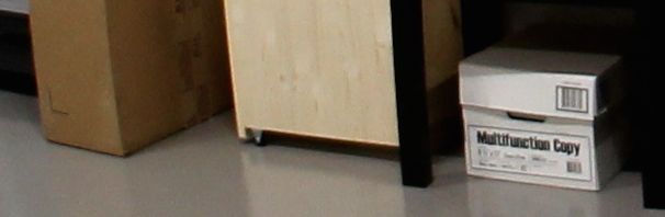

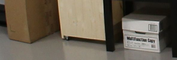

I am testing VPU JPEG image decoding using this sample:
https://community.freescale.com/thread/318147
The decoder outputs YUV pixel format which is then converted to RGB using g2d_blit(). I then encode the buffer back into JPEG using SW jpeg library. For comparison, I decode and then encode the same image using only SW jpeg library. I see subtle color differences between the HW and SW decode. I am attaching two images for comparison. It appears the VPU decoder or g2d_blit conversion enhances contrast (see how much darker the top of the white box on the right is for HW decode compared to SW decode) and bumps up red color (see the cardboard box on left is more red for HW decode). The SW decode produce the output images that matches the input image.
Any ideas why this is happening and if it can be fixed? Is there another way to to HW YUV to RGB conversion?
Alex
This is HW decode:
This is SW decode, input and output images are identical:

alik
Hi Bio,
I did make sure that I have blend, dither, etc disabled. I think the root cause is that there are multiple formulas for YCbCr > RGB conversion. The one used in GPU uses Y clipping according to the IMX6 reference manual, whereas the one normally used in JPEGs uses full range, eg see https://en.wikipedia.org/wiki/YCbCr
I do not know which conversion is used in MJPGs, I would expect it to be the JPEG one. In that case Freescale has a bug in the implementation. Making selection of a conversion algorithm available would be a solution too.
