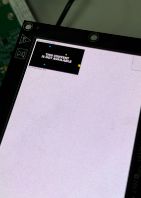

Dear nxp engineers,
We integrate Cog web broswer, mesa, imx-gpu-ivv library and driver in our build.
When using Cog to display a straightforward HTML page, it sometimes displays a random black block on the screen.
cog --platform=drm --platform-params="renderer=gles" test.html
It looks like the issue is cog + gpu related.  I attached a video for you to check.
Could you help to check if there is any known issue with cog + imx8mq?
html is very simple:
<body>
<header>
This is the Header Text
</header>
<main>
<img src="https://media.giphy.com/media/ICOgUNjpvO0PC/giphy.gif" alt="Funny GIF">
<!-- img src="https://upload.wikimedia.org/wikipedia/commons/9/9a/Gull_portrait_ca_usa.jpg" -->
</main>
<footer>
This is the Footer Text
</footer>
</body>

wenyong
Hi Zhiming,
please check the video for the issue I experienced when playing video with cog.
cog --platform=drm --platform-params="renderer=gles" test3.html
Again a very simple html page called test3.html to test:
Please also download the video resource referenced by test3.html.

Zhiming_Liu
Hi @wenyong
Also no such issue on L6.12.20.
Zhiming

Zhiming_Liu
Please share the BSP version.
Zhiming

wenyong
Hi Zhiming,
We are on
tag: rel_imx_5.15.71_2.2.0, origin/kirkstone-5.15.71-2.2.0
Wenyong

Zhiming_Liu
Sorry, I don't have much time to test other versions. I tested it on L6.12.20, the latest version, the display is normal. Not sure if this issue is caused by mesa or viv property driver.

wenyong
Hi Zhiming,
I upgrade yocto version to scarthgap, meta-imx's scarthgap release has kernel 6.6 build.
The black block issue seems to be better, I only see it if I with cog to open a non-exsit webpage.
how about playing video with cog? Playing video with cog seems to be pretty bad, I have flickering contents when playing and the UI components is messed up. I'll upload an video.
