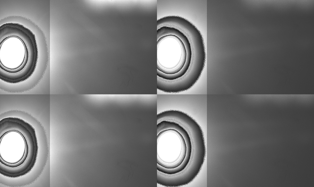

We've been working with an IMX334 image sensor on the dart-mx8m development kit. We are trying to capture a 4K@30 fps streaming. We configure the image sensor to use 4 lanes (891 Mbps/lane) and RAW10 but so far we only get distorted images (see images below). Frame rate is not correct either.
We've already validated that is possible to capture RAW10 images with two other sensors, the OV5640 and the AR0144 (750 Mbps/lane).
From these tests, we have observed that the main difference of the IMX334 with respect to the other sensors already validated, is the data rate and the number of CSI-2 lanes.

jafet_chaves
Just wanted to give you an update on this issue, we've been able to capture 3672x2180@30fps, 4 lanes, RAW10 successfully but the expected resolution is 4K@30fps, this could be related to sensor configuration (we're figuring it out internally). But if you have any input about the mismatch in the resolutions (from the i.MX8M perspective) please let us know.
Additionally, we had to apply some changes in the i.MX8M kernel (some of them were taken from newer kernel version as suggested by Bio_TICFSL others we're already added by us):
*CSI_CSICR18 bit 4 (BASEADDR_SWITCH_EN) was set to 1 (drivers/media/platform/mxc/capture/mx6s_capture.c)
*CSI_CSICR18 bits 19-18 (BASEADDR_SWITCH_EN) were set to 10 (drivers/media/platform/mxc/capture/mx6s_capture.c)
* We set assigned-clock-rates = <266000000>, <333000000>, <66000000> in the device tree (arch/arm64/boot/dts/freescale/fsl-imx8mq.dtsi).

edison_fernande
Hi Bio_TICFSL
By using the suggested clocking configuration (266, 333, 266) MHz we have been able to get the best results out of the imx334, however the capture is still not correct.
The sensor is configured to generate 3864x2180@30 frames with a data rate of 891Mbps/lane using 4lanes and this seems to be in the supported range of the iMX8 (1.5Gbps/lane).
If we use the recommended configuration, we can capture perfect frames if we configure the imx8 to receive a frame of 3672x2180 pixels (when the sensor is sending 3864x2180) .
If we configure the sensor to generate 3840x2164, we can capture "good" frames configuring the iMX8 to receive a frame of 3650x2164 and if we configure the sensor to generate frames of 3648x2164 we can see the frames using a width of 3466 so it looks like we are always capturing a width under the expected value by a fixed rate.
The sensor always  gives a constant data rate so in all these tests we have been receiving 891Mbps/lane.
I also run a second test to see if I was able to receive the video at the expected resolution.
I set the CORE clock to 266MHz, and sourced the PHY clock from the AUDIO PLL2 clock to be able to more precisely control the PHY clock frequency. With this configuration, I got the best results using a PHY clock of 351.4485MHz, with the sensor configured at 3848x2164 I was able to receive video configuring the iMX8 at 3460x2164, if I increase or decrease the PHY clock by really small values (350 or 352 MHz for instance) the framerate goes down and the captured frames no longer make sense.
Finally, is good to mention that the cases where I receive "good" video, if I capture several consecutive frames, I can see the video "shifting" to the left.

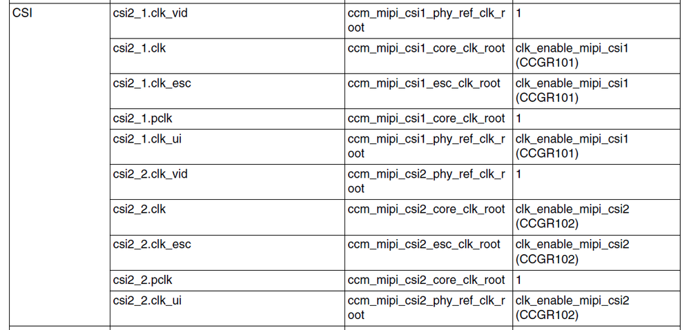

Bio_TICFSL
Hello ye,
    Please check the table from 8M RM  for relation between clk and clk_ui with the properties CORE/PHY.A84A2B0.PNG

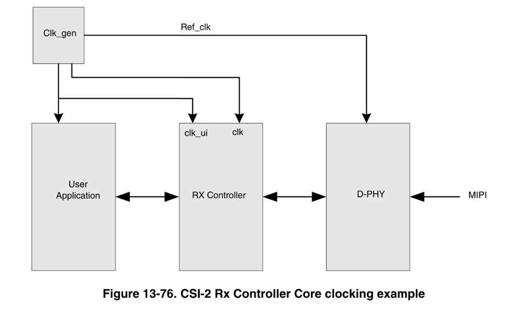

felix_ye
Hi Jafet,
I also confused about the i.MX8MQ MIPI CSI clock configuration.
But I don't think "clk_ui is what is called PHY" as you said.
Just see this clock block diagram in i.MX8MQ RM P4994.
Felix
