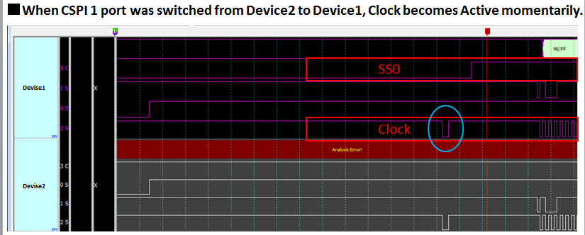

We connect three devices to ECSPI1 port.
We use fsl-yocto-3.10.53-1 .1.0.
The ECSPI driver remains a default.
When ECSPI1 is switched from SS1(Device2) to SS0(Device1), a clock is output momentarily just before SS0 becomes active.
Why is a clock output?
The field setting of each register is the following
ECSPI1_CONREG
- CHANNEL MODE:1 (all master mode)
- SMC: 0
ECSPI1_CONFIGREG
- SCLK_CTL:1 (stay high)
- DATA CTL:0 (stay high)
- SS_POL:0 (Active Low)
- SS_CTL:1 (Negate Chip Select (SS) signal between SPI bursts)
- SCLK_POL:1 (Active low polarity)
- SCLK_PHA:1 (Phase 1 operation)
May I have advice?

[For glitch with CS-GPIO]
The glitch timing is random.
And there is the case that glitch width is increased.
In this case, CS becomes active during glitch of the clock.
As a result, eCSPI reads unpredictable value.
Is there the method to make a clock line High forcibly?
Please see waveform of the increased glitch width.
The attached file is ECSPI_glitch_on_clock.xlsx.
Is it effective that a dummy reed is put when SS is switched?
Could you give me some advice?

Thank you for your support.
In NXP Linux BSP, GPIO controls an SS signal.
This GPIO (SS signal) does not synchronize with a clock.
An SS signal may be asserted before this glitch occurs.
In this case, unpredictable data is read.
We do not know why glitch of the clock occurs.
We are looking for a method avoiding this glitch.
