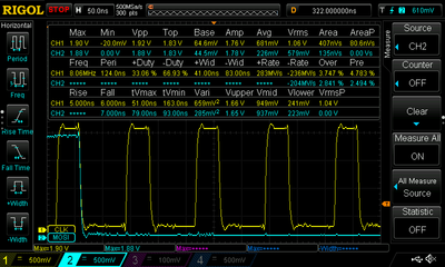

we have a problem with the lpspi6 clock on the i.MX 93. When we measure the clock signal with an oscilloscope, we can see that the high-level phase and low-level phase have different lengths. The low-level takes about 66% of the period, and the high-level only 33% of the period (see attached image 'SPI6_QuickPrint60.png'). 
We observed that behaviour with NXP BSP version "6.6.52_2.2.0". We measured the lpspi6 clock also with the older BSP version "6.1.55_2.2.0". With that older version we see that the clock signal behaves as we would expect it (50% high and 50% low).
Unfurtunately, with that wrong duty-cycle of version "6.6.52_2.2.0" we miss the limits of the spec of the connected SPI slave.

Do you have any idea which impact the software can have to the duty-cycle of the lpspi6 clock?
Do you have any idea how we can narrow down the problem?

Hi @Chavira  ,
> What board are you using?
We have our own custom board.
>Are you using the A1 silicon version of the chip?
Yes, we have rev A1.
> The issue is happening only with device that you are connecting?
I can not answer that, as we have only that device connected. However, what I can say is, that it seems to be somehow related to the software BSP version:
  • In the past, we used NXP BSP version 6.1.55_2.2.0. With that, the spi clock duty-cycle was 50%/50%, as we would expect it.
  • When we updated to NXP BSP version 6.6.23-2.0.0, we saw this wrong spi clock duty-cylce of 33%/66% for the first time.
  • Also with the current latest BSP version 6.6.52_2.2.0 this wrong spi clock duty-cylce of 33%/66% occurs.

cstoidner
Hi @Chavira ,
we tested it also on lpspi1. We had no slave connected, but during the tpm request from the imx93 we can see the clock. It is also other than expected (about 61% low and 39% high).
Any clue what can impact the SPI clock's duty cycle?
Christoph
