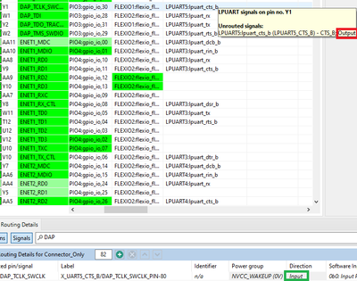

But in the Pinmux config tool 24.12 I see:
  • CTS_B as Output (i.MX93)
  • RTS_B as Input (i.MX93)
  • CTS_B as Input (i.MX8M Plus in DCE)
  • RTS_B as Output(i.MX8M Plus in DCE)

1 ) According to i.MX93 RM,  RTS is output and CTS is input.  while in iMX8MP RM,  CTS is output and RTS is input.  They are using different naming conventions.
2) Unfortunately, the direction in config tools for both SOCs are inverted.  An internal ticket was created for this.

Hi @danielchen,
After updating to the latest MCUXpresso config tools v25.06, we noticed an inconsistency regarding the CTS/RTS pin directions on the i.MX93:
  • In the Routing Details window, the directions are now correct (CTS = input, RTS = output).
  • However, if you hover over the muxing options in the Pin List, the directions are still shown incorrectly.
This makes the tool internally inconsistent for the i.MX93.
Could you please confirm if this is a known issue, and whether it will be addressed in a future release?
