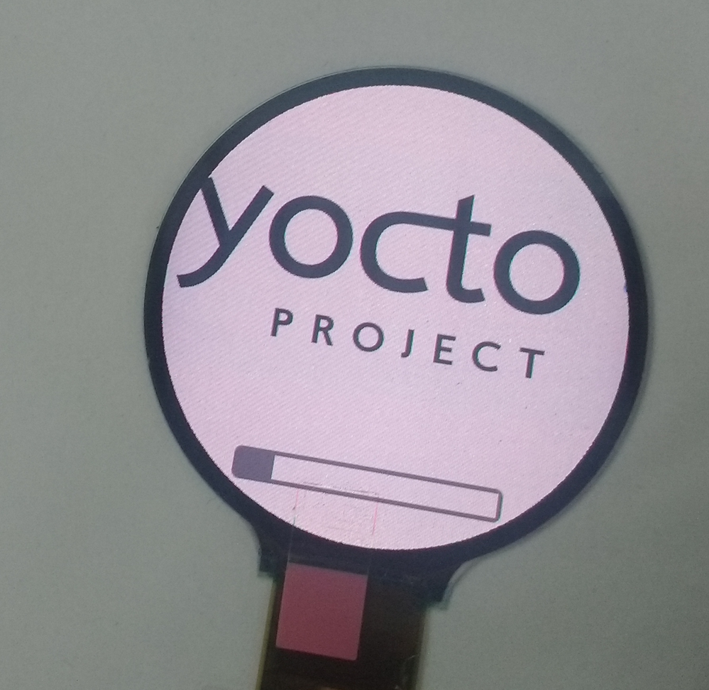

nandishguruling
Hi  Bharghavi K,
What you see in the above pic is Plash Screen not Boot logo,Then you need change the Plash Screen,please do the following steps :
convert yourimage.* to yourimage.h, then follow below steps,
1) copy the myimage.h to ../../../sources/poky/meta-yocto/recipes-core/psplash/files/myimage.h.
2) MACHINE=your-machine-name  source fsl-setup-release.sh –b build –e fb.
3) bitbake your-image-name.

Hi nandish,
Thank u,I converted the image .* to myimage.h.Copied to fsl-community-bsp/sources/poky/meta-yocto/recipes-core/psplash/files/
While executing ->MACHINE=wandboard  source fsl-setup-release.sh -b build -e fb
I'm getting as like below mentioned.
bash: fsl-setup-release.sh: No such file or directory.
How can i solve this issue?
Thanks in advance.

bhargavik
Hi nandish gurulingappa,
I tried the above u suggested steps.After power on the my wandboardboard-quad it is displaying wandboard.org logo not displaying my logo.I followed steps as mentioned below is any wrong  please let me know.My actual image is below mentioned.
Converted .png to .pnm and .pnm to .ppm
step-1.
-->pngtopnm whileboot.png > linuxlogo.pnm
-->pnmquant 224 linuxlogo.pnm > linuxlogo224.pnm
-->pnmtoplainpnm linuxlogo224.pnm > linuxlogo224.ppm
step-2.
Later moved the linuxlogo224.ppm file to build/tmp/work/wandboard_quad-poky-linux-gnueabi/linux-wandboard/3.10.17-r0/git/drivers/video/logo replaced it as logo_linux_clut224.ppm
step-3.
Compiled the image
-->bitbake core-image-minimal
The image flashed to sdcard by below command
-->sudo dd if=tmp/deploy/images/wandboard-quad/core-image-minimal-wandboard-quad.sdcard of=/dev/sdb bs=4M && sudo sync
And finally verified on my target board its not displayed my logo.What is the issue?Please let me know.

nandishguruling
Hi Bharghavi K,
Nandish SG
