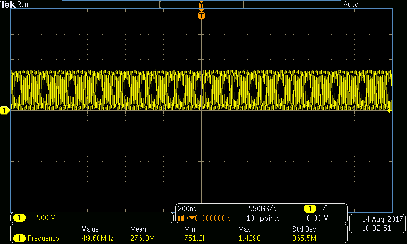

I am using IMX6DL and linux kernel 4.1.15 , uboot 2015.04.
I understand that imx6 support eMMC 4.x with HS200 and default speed of mmc is 52Mhz.
I have 2 questions :
- How can I know that eMMC is working with SDR or DDR?
- How can we change speed of mmc for eMMC? which speeds will it support?
Can we set clock of mmc < 26Mhz ? I want to reduce it for EMC product testing.
In Uboot, I tried to change speed to difference value as below :
drivers/mmc/mmc.c
mmc-> tran_speed = 2000000 ;
but after boot, I alway got 52Mhz from command :
cat /sys/kernel/debug/mmc3/clock
52000000
Thanks & Best Regards,
Dong

Hi igor,
Thanks so much for your reply.
I don't know why I still got 52Mhz after change like your suggestion to many difference values < 52000000 in uboot : min(cfg->sdhc_clk, (u32)52000000)
Don't have any changing after change that code.
Below is image that I captured clock from OSC when I run test eMMC, It alway is 49.x Mhz.
Dong

Hi igor,
Yes, I already changed with many other value ( < 52000000).
Some value I tried to change like : 26000000, 40000000, 46000000,....But nothing change, I still got same clock at above picture , about 49.6Mhz when measuring by OSC or by command like below :
52000000
Dong
