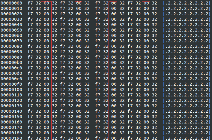

I use GATE Mode to capture stream, and it works. but the data I got was wrong.
The data in red box should be DC,  and it always in same wrong in same place.

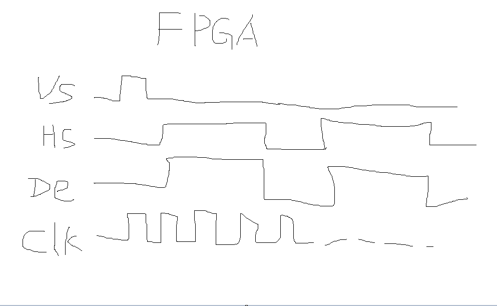

The FPGA wave is like this:

clock can be adjusted in ../mach-mx6/clock.c for gated mode
may be useful
https://community.nxp.com/docs/DOC-97981
~igor

IPU_INT_STAT_5 = 0x00000002 may mean new frame starts before the previous
end-of-frame event as result of data rate problems. Such problems may be a
result of the IPU running in slower clock then required by the use case.
igor
