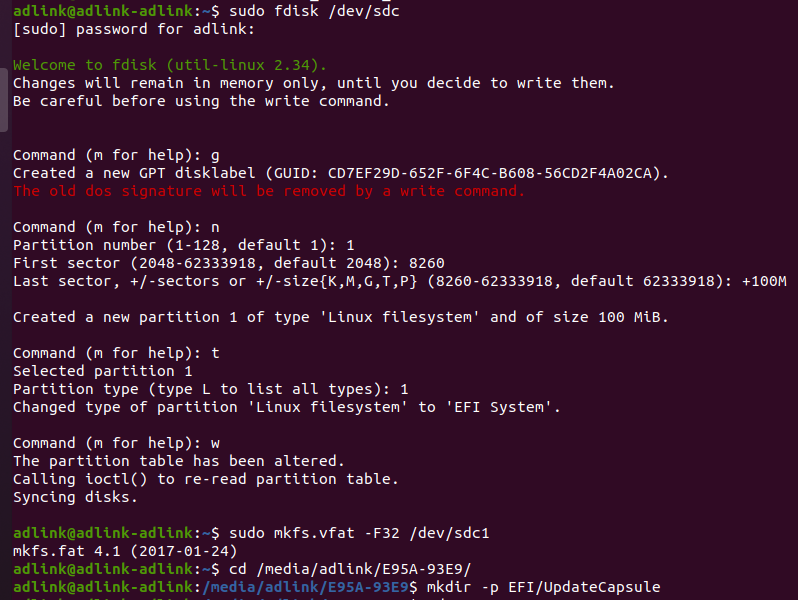

4.Created an EFI partition using the appropriate image:-

arka
Hi @JosephAtNXP ,
Can you share steps on how to create EFI partion and flash the uboot on sdcard?
Write 8MMini SystemReady-IR certified bootloader to SDCard
Mark mmcblk1p1 partion as EFI (with fdisk tool)
