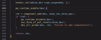

I'm having some  troubles getting my display to work (TX18D211VM0BAA) with the i.MX7ULP. The display is using LVDS for communication, thus I have place a MIPI_DSI-LVDS bridge (SN65DSI83TPAPRQ1) to convert the signals for the display.
When booting Linux, it all seems fine:
root@imx7ulpevk:/# dmesg | grep -i -E "mipi|sn65|lcdif|video|drm|panel"
[ 0.085332] platform 40a90000.mipi_dsi: Fixed dependency cycle(s) with /bus@40000000/lpi2c4@402b0000/sn65dsi83@2c
[ 0.134710] platform 40a90000.mipi_dsi: Fixed dependency cycle(s) with /bus@40000000/lpi2c4@402b0000/sn65dsi83@2c
[ 0.135162] i2c 2-002c: Fixed dependency cycle(s) with /bus@40000000/lpi2c4@402b0000/sn65dsi83@2c/panel@0/ports/port@0
[ 0.135253] i2c 2-002c: Fixed dependency cycle(s) with /bus@40800000/mipi_dsi@40a90000
[ 0.142246] videodev: Linux video capture interface: v2.00
[ 0.146419] MIPI CSI2 driver module loaded
[ 0.564469] mipi_dsi_northwest 40a90000.mipi_dsi: i.MX MIPI DSI driver probed
[ 2.187945] [drm] Initialized vivante 1.0.0 20170808 for 41800000.gpu on minor 0
[ 7.157978] systemd[1]: Starting Load Kernel Module drm...
[ 14.327604] systemd[1]: modprobe@drm.service: Deactivated successfully.
[ 14.514570] systemd[1]: Finished Load Kernel Module drm.
though at the very end of the boot process I do get a notice the the Psplash failed to start:
[FAILED] Failed to start Terminate Psplash Boot Screen.
See 'systemctl status psplash-quit.service' for details.
Below is the snippets from the dts, that shows the configuration of the bridge and panel.
Do anyone have some ideas why nothing is shown on the display? Is there something that I'm failing or missing to do?

The sn65dsi83 probe function pries to lock PLL from MIPI-DSI before imx_sec_dsim_encoder_atomic_enable() function ensbles it.
Moved piece of code that sets PLL to sn65dsi83_atomic_enable() function.
This problem was fixed after I adding
loglevel=8 drm.debug=0x1ff
to kernel commandline.
It was incorrect LVDS timing configuration so the mode was rejected.

I tried to apply the patch but it seems that the version (scarthgap 6.6.52) already have the modification in place. When applying patch, i tried to make a dry run and get the message:
"error: drivers/gpu/drm/imx/sec_mipi_dsim-imx.c: patch does not apply"
Looking into the file that are going to be patched, the lines that are added is found a little further down in the file.
This means that the patch unfortunately does not solve the problem.
Other suggestions to solve the problem are very welcome:-)
