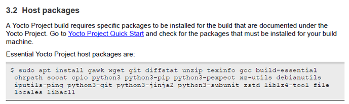

HI @dewey :
cannot find -lstdc++—during the Yocto build for the Real-time Edge Software on Ubuntu 22.04 LTS is typically due to missing development libraries for C++ on the host system.
I would suggest you update the gcc version in your host system.
Please install all the required host packages according to UG10164: I.MX Yocto Project User's Guide

Hi, Daniel
     Thanks for your reply, The machine's local gcc was incorrectly set to gcc9 by update-alternatives, and it was modified to gcc11 to compile successfully.
