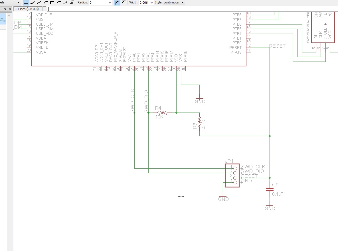

I am using a J-Link v10.1 running J Link GDB Server to connect to a MKL82Z128Vxx7 microcontroller on a custom board. I am unable to connect to the board.
As you can see in the picture, I have a 4.7K pullup resistor for RESET, and 0.1uf capactior to ground. On SWD_DIO I have a 10K pull up resistor.
I am attempting to use SWD to connect.

Hello Free Lance,
    1. The SWD external circuit is correct.
    2. NMI pin please also add external 4.7K to 10K pull up.

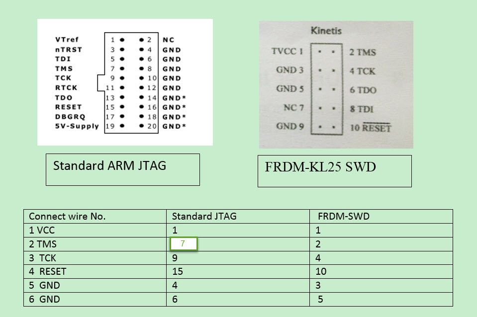

    3. The SWD connection in your JLINK side.
  This picture is for your reference, you need to connect your 20 PINS interface in the JLINK, pin1 should connect to 3.3V.
  4. You must make sure your JLINK debugger can support the kinetis.
