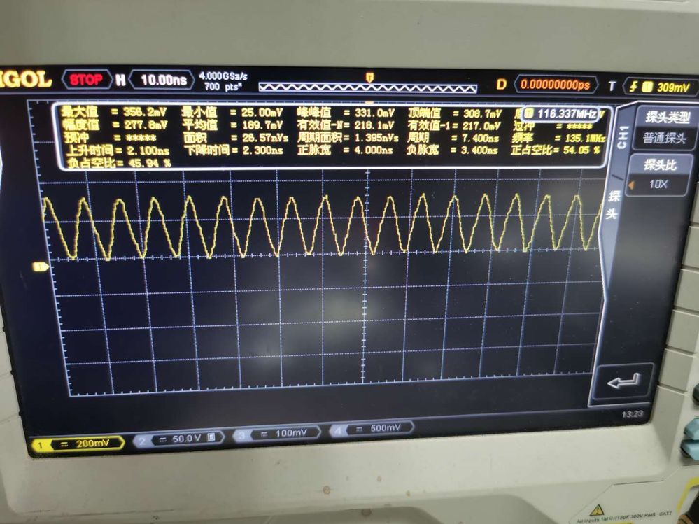

Currenty I am working on i.MX8M Nano with Camera module Pico DCAM20 (2 lanes). To add support for this driver, I added the driver file addi903x.c as attachment.
Mark , the addi903x need 2 lanes 135Mhz mipi clk RAW12bit
In our Linux 5.4.3 MIPI driver added support for MEDIA_BUS_FMT_SBGGR12_1X12 like this:

After boot, driver is initialized and DCAM20  is detected, /dev/video0 and /dev/media0 nodes are also created.

>>About MIPI signals
After the MIPI signal is amplified, check whether there is a short packet in the data.
【注】Here let me write it in Chinese.
现在面临的问题是,CPU收到的数据包中,没有帧头和帧尾,那么数据会被丢弃。因此可以看到有数据进来,但是没有被处理。

2802911181
Hi Wigros,
  MIPI CSI2 clock as below:
mipi_clk.jpg The clock is OK but it still stuck.
6,758 Views
