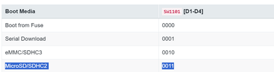

Dear Team,
i try to boot from SD card with IMX8 board
i followed the instruction for kit imx8mp evk
However, cannot success and received the log below:
“ U-Boot SPL 2023.04-lf_v2023.04+g1e5b6c6bf2 (Sep 05 2023 - 06:13:49 +0000)
DDRINFO: start DRAM init
DDRINFO: DRAM rate 4000MTS
Training FAILED “
Please help me check and advise
Brgs,
Thinh

Hello @ThinhNguyen_FE
I guess you are using i.MX8MP EVK, so, please download a BSP from Embedded Linux for i.MX (you can try with L6.1.36_2.1.0_MX8MP) and please load the downloaded BSP to the board using UUU tool.
For download the BSP with UUU tool, please follow the below steps:
1. Put board in Serial Download mode changing SW1101 [D1-D4]
Connect trough USB your PC and the EVK.
Turn on the board.
To test if the board is in serial download mode you can write command:
If using Linux
$ sudo uuu -lsusb
If using Windows
> uuu -lsusb
And the logs should describe the hardware that is connected to your PC, in this case i.MX8MP.
2. Assuming the SDcard is connected to EVK, go to the directory where you downloaded the BSP and run the below command:
If using Linux
$ sudo uuu -b sd_all imx-boot-imx8mp-lpddr4-evk-sd.bin-flash_evk imx-image-full-imx8mpevk.wic
If using Windows
That command will download the image in the SDcard of the i.MX8MP.
3.When the download ends, put the board to boot with SD:
Then it can boot successfully.
Please let me know if any problem.
