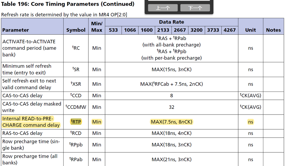

anhui527
in generated timing file of 2400Mbps , a obvious error is that tRTP is set to 6.66ns, but the LPDDR4 device datasheet says that tRTP should be MAX{7.5ns,8*tCK}.
in genertated timing file of 3200Mbps , tRTP is set to 7.5ns.
for NXP experts reference.

and more info below:
there are (address, value) pair in config file lpddr4_timing.c, one of these pairs is { 0x3d400104, 0x504a6 }, which indicates the register(SDRAM Timing Register 1 (DRAMTMG1))  at addresss 0x3d400104 should be set as 0x504a6.  and in this register , the field rd2pre is bit[13:8](0x4 or 0'b0100) , and it is explained as
tRTP: Minimum time from read to precharge of same bank.
- DDR2: tAL + BL/2 + max(tRTP, 2) - 2
- DDR3: tAL + max (tRTP, 4)
- DDR4: Max of following two equations: tAL + max (tRTP, 4) or, RL + BL/2 -tRP (*).
- mDDR: BL/2
- LPDDR2: Depends on if it's LPDDR2-S2 or LPDDR2-S4: LPDDR2-S2: BL/2 +tRTP - 1. LPDDR2-S4: BL/2 + max(tRTP,2) - 2.
- LPDDR3: BL/2 + max(tRTP,4) - 4
- LPDDR4: BL/2 + max(tRTP,8) - 8
(*) When both DDR4 SDRAM and ST-MRAM are used simultaneously, use SDRAM's tRP value for calculation.
When the controller is operating in 1:2 mode, 1T mode, divide the above value by 2. No rounding up.
When the controller is operating in 1:2 mode, 2T mode or LPDDR4 mode, divide the above value by 2 and round it up to the next integer value.
Unit: Clocks.
so the tRTP timing value(in hardware Memory Controller,BL=16 for LPDDR4 usage) should be BL/2 + max(tRTP,8) - 8 = 8*tCK=8*(1/1200M)=6.66ns.
but in datasheet of Micron LPDDR4 device , the tRTP should be MAX{7.5ns,8*tCK} which is in attached picture.
and could you please help confirm if 2400Mbps config could really work well ?
thanks.

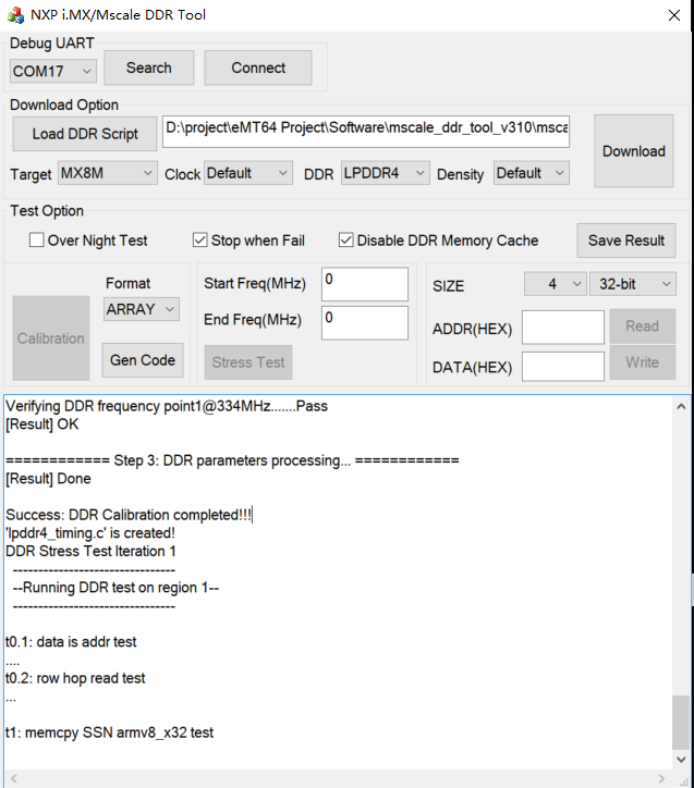

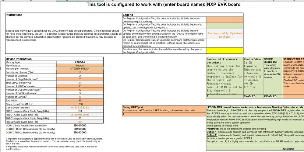

anhui527
the attached pictures above.
we will provide more info if needed.
