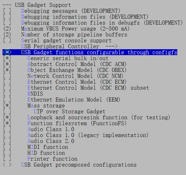

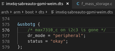

Our bsp version is based on 4.14.98_2.0.1, I also tried 4.14.98_2.1.0, but still failed to synchronize files: ls command can't shows files created from Windows before rebooting board. Maybe remount should works, but shoundn't be synchronized once the file was created from Windows? I also tried refresh folder on Windows and sync from our board, but nothing happened.
Here are my settings. Is there something I missed?
Device Tree

menuconfig:
console log, full debug log also attached
