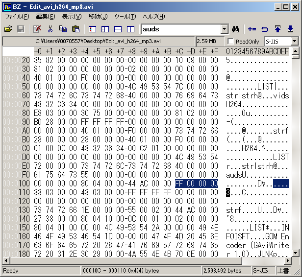

Please check below step.
[Steps]
1. Get the .avi content.
 ex)  Download the "avi_h264_mp3.avi" from below link.
 http://www.gomplayer.jp/player/support/sample.html
2. Open the "avi_h264_mp3.avi" file by binary editor.
3. Search the "auds". The address is dwStart after 25 bytes from there.
    Modify the dwStart (4Bytes). Refer to below image.
    (Before) :  00 00 00 00
    (After) : FF 00 00 00
4. Play the content on SABRE-board with android jb4.2.2_1.1.0.
PS,
The modified .avi content was played successfuly with 6 sec delay by Windows Media Player(PC).
In latest BSP (android 6.0.1_2.1.0, KK4.4.2_1.0.0), the same issue was confirmed.
Keita
