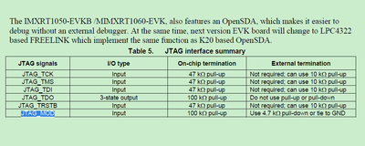

I have an issue with debugging / accessing the controller with J-Link. GPIO pins are initially set as input pins after a reset (corresponding registers default as 0). Whenever a high signal is applied to one of these GPIOs the J-Link probe fails to connect to the target. In my specific case, one GPIO is later initialized as a CS for SPI communication (slave). Therefore, the device the iMX is communicating with is raising the signal before I can start the debugging process and the probe fails to connect via SWD. If the CS line is cut I can debug as usual.
Is there a way around this behavior? Unfortunately there is no proper way in the given system to keep the CS line low when programming.

Michi_O
Hi Kerry,
thanks for your response. Additionally to my previous findings I figured out that not (only) a high signal on the observed pins is causing the connection issue. It also appears when a pin is simply connected to the rest of the system. Unfortunately, the behavior can't be determined by specific pins. It is completely random and may or may not occur when a certain pin is connected. However, when the controller board is connected to the system with all pins (LPSPI1 - LPSPI4, LPI2C1 and a few GPIOs) the debugger can never connect.
I could see that in such cases the SWDIO and SWDCLK lines change their initial level (sometimes high, sometimes low). I fixed this by applying pull-ups as stated by the table from your previous post. The JTAG_MOD pin was pulled-down by 100k which I also changed to 4.7k as stated in the table. Unfortunately, all measures were unsuccessful.
Michael

kerryzhou
Hi @Michi_O ,
  Please tell me which detail pin you use will influence the debugger? Whether it is the JTAG_MOD pin or other SWD related pins?
This pin needs to be low, otherwise, it will influence the debug mode.
Wish it helps you!
Kerry
