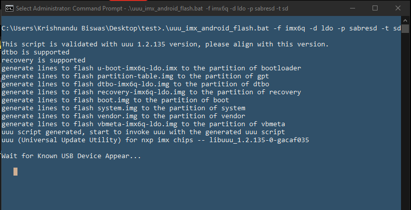

krishnandu_bisw
Thanks for your fast reply,
But have read my problem description (not just log), because I've mentioned every possible details.
I'm using an SD-card of 8GB(actually 7.38GB) and not emmc and also I'm using fsl_sdcard_partition script for partitioning and flashing.
All the partition are being created properly because I have configured the partition table according to the size of raw images. So the images are flashed properly and not overlapping on other partitions.
When I use UUU with flash script this output appears and remains stuck.
Is it because the libuuu version is 1.3.134 and uuu version required is 1.2.135?
14,724 Views
krishnandu_bisw
I also tried with uuu 1.2.135....
14,724 Views
