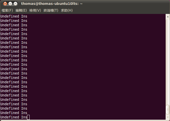

Found a trouble recently. The EVK can't boot by LTIB and Yocto build.
Anyone have idea to fix it?
LTIB build SD
Yocto Build error.

PeterChan
It looks something is wrong after change the cpu frequency. In the file ltib/rpm/BUILD/imx-bootlets-src-2.6.35.3-1.1.0/boot_prep/init-mx28.c, would you please define "MEMORY_TEST" and rebuild the boot stream to see if the memory test can pass?

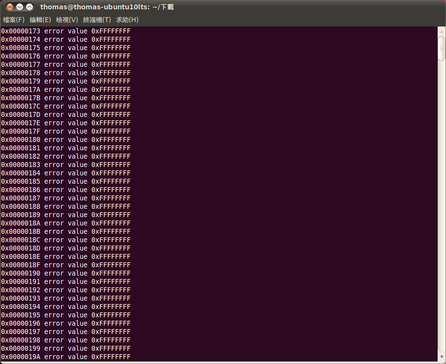

PeterChan
Yes, I meant to enable this piece of code in boot stream and see if messages "start test memory accress" and "finish simple test" can be shown. Otherwise, your board may have hardware problem.

thomaslin
Dear all,
Thanks, root cause found. EMI_VREF =0V!!
So, check R29 tie to ground in both end. Resolder R29 and the system can bootup now.
Thanks all of your help.

thomaslin
I only have one EVK,
I use 3 kinds pribuild images original Linux image, LTIB prebuild by Ubuntu and Yocto fsl-test image. Test all of them fail.
The pics are fail shown in debug message.
