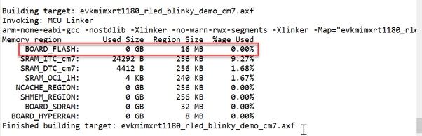

I can debug through LinkServer or JLink just fine but when I try to Program Flash it fails. I have attached the Console output for the LinkServer. I am trying to flash and boot from FlexSPI qspi. Any help on this would be great thanks.
435 Views
Kan_Li

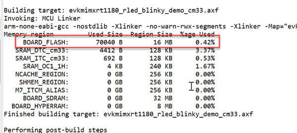

Hi @jett ,
The project you want to program into the flash is a RAM target indeed, as it is for M7 which is not the default boot core of RT1180.
Please use the project for M33 instead.
