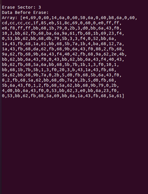

Hi everyone,
I'm using Teensy4.1 Board. It include MIMXRT1062DVJ6B and external flash W25Q64JVSSIQ.
I used evkmimxrt1060_flexspi_nor_polling_transfer to read, write and erase the external flash.
But i have issues: Cannot erase sector 3,4,6,7. In while others can be erased.
Below is my configuration and test:

***************************************** Case Erase 3-4 (Failed)*********************************

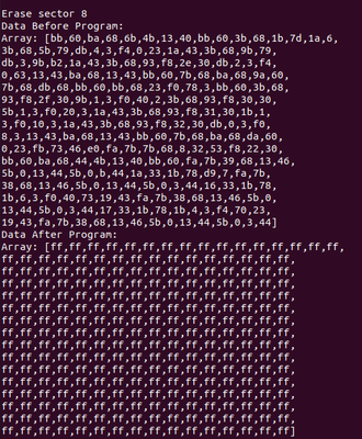

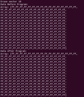

 ***************************************** Case Erase 8-9-10 (Success)*********************************

jay_heng
It is interesting, but from you 'erase3/4' picture, i don't see the data difference between Data Before Program and Data After Program.
If some block/sectors cannot be erased, you need to check Status Register-1

xuanthodo
Thanks for your response,
From erase3/4 picture, It cause blocking process after I send erasing command sector 3,4.

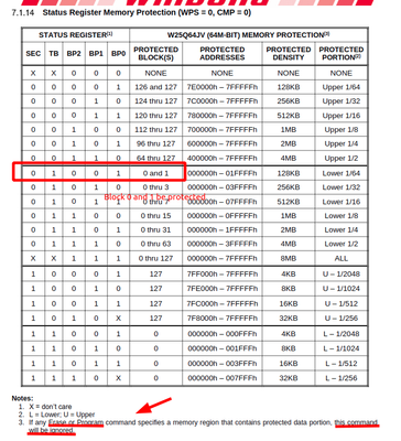

About Status Register-1, I checked that it's in PROTECTED BLOCK 0 and 1 (attached image).
So I still don't know why i can erase other sector (5,8,9,...) , in while it's in BLOCK 0 and 1.
