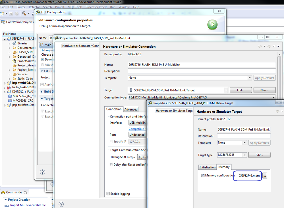

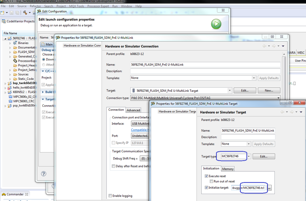

Hello Selvakumar
Are you using CodeWarrior v10.6.4 to develop the project on 56F82746? Could you please check whether you have selected the correct target type, initialization file and memory configuration file for 56F82746?  Please see the screenshots as below:
You will be able to find these options by these steps:
  1. Open the Project Properties from Project Menu-> Properties.
  2. Click on Run/Debug Settings, and select the active launch configuration and click on ‘Edit’ button.
  3. On the pop-up “Edit Configuration” dialog window, click on the ‘Edit’ button after the ‘Connection’ selection list.
  4. On the pop-up “Hardware or Simulator Connection” dialog window, click on the ‘Edit’ button after the ‘Target’ selection list.

selvakumarm
Dear Fiona,
Thanks for prompt response. After i changed target settings its working fine.
The memory configuration file name does not changed under the folder of Project_Settings -> Debugger->56F82726.mem. But contents of the file, memory is mapped to 56F82746. Please check once.
