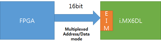

I want to data transfer from FPGA. (16bit data bus)
Can i use EMIF? If i want to use EMIF , what interface can i use?
MMDC? or WEIM?
I think to usually use EIM. right?
If the wrong decision, please tell us.
If i use EIM, can i use like below?
Can i have EIM example code or manual.. or other solution.. for data transfer use EIM from FPGA ?

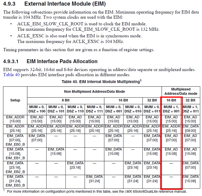

Can i have a question?
Max operating frequency for EIM data transfer is 104Mhz.
if when i use multiplexed address/data mode, is EIM data trasfer rate 52 Mhz?
Do you know that data transfer rate for multiplexed mode?
1,939 Views
andrewdyer
we used EIM in multiplexed mode with an FPGA to do 32-bit transfers and got avg. cycle times of 456ns for a read and 436ns for a write.  The actual transfers were taking 156ns for read and 148ns for write and the i.MX6 was inserting about 300ns of delay between cycles (known issue discussed on these forums before).  I suspect it would be possible to shave a few cycles off of the read and write times with more work, but this was sufficient for us.
1,939 Views
igorpadykov
clock requirements are the same in multiplexed address/data mode
and timing diagrams can be found in datasheet and RM (EIM chapter).
