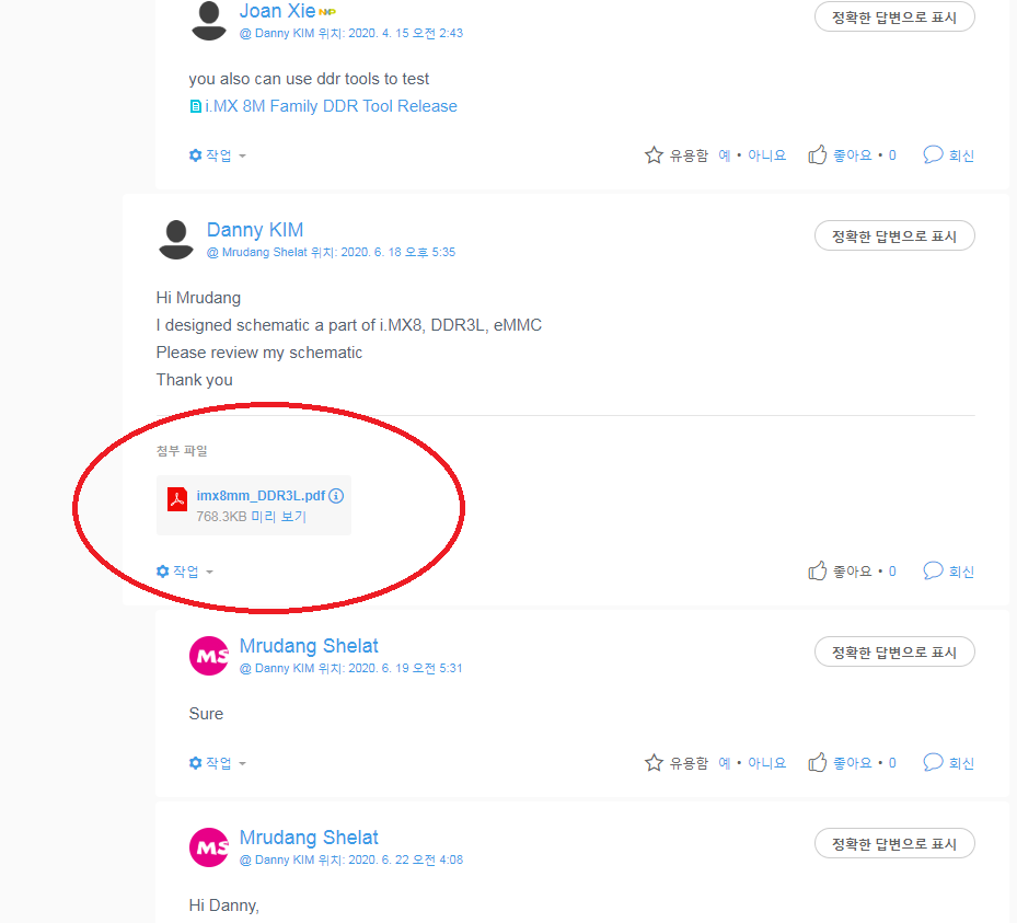

danny_kim
Hi Mrudang
I designed schematic a part of i.MX8, DDR3L, eMMC
Please review my schematic
Thank you

mrudangshelat1
Senior Contributor II
Hi Danny,
Please refer to IMX8MMHDG: i.MX 8M Mini Hardware Developer’s Guide for DDR3L.
  • Refer complete sec 3.4 DDR design recommendations for pin signal assignment, signal swapping etc.
  • Also, refer to reference schematic pg. no 5 of SCH-35104 for DDR3L interface and net swapping based on signal routing.
  • eMMC interface looks good. (Reference pg. no 9 of SCH-31399 C2)

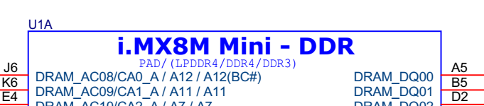

mrudangshelat1
Hi Danny,
The schematic is based on DDR4 and LPDDR4. but they have also mentioned DDR3 as well. It means this reference schematic is also applicable for DDR3 signal interface as well.
Section 3.4 of  IMX8MMHDG: i.MX 8M Mini Hardware Developer’s Guide has provided pin signal assignment for all 3 DRAM.

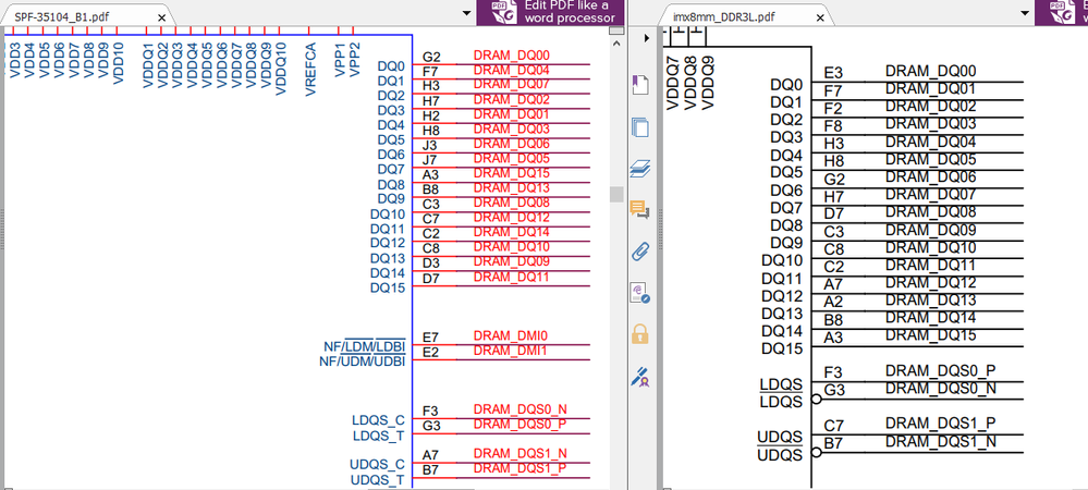

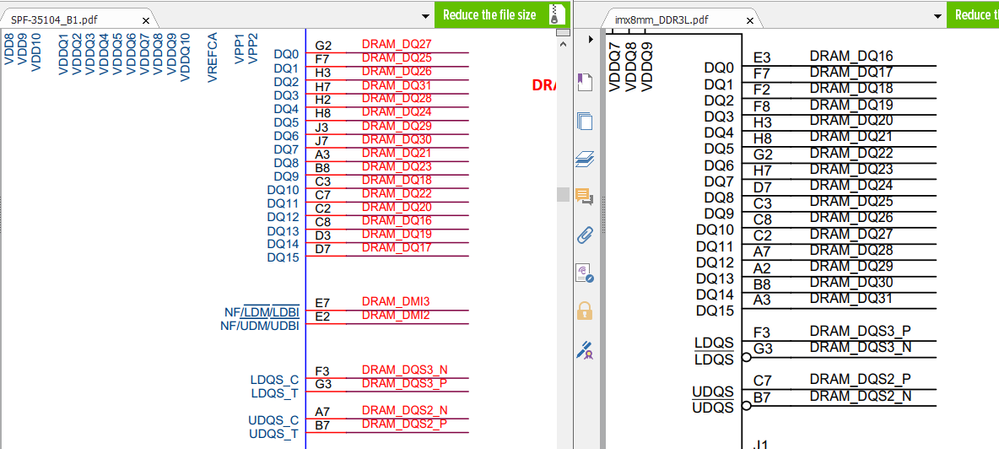

danny_kim
Hi Mrudang
I referred to the document composed of DDR4 (SPF-35104) and prepared a circuit diagram for review. (The circuit diagram was attached)
Have you seen the circuit diagram I attached?
If you have seen it, please give me a comment on it
According to the document (IMX8MMHDG: i.MX 8M Mini Hardware Developer's Guide), when using DDR3L, it seems to use four DDR3L.
However, the circuit diagram using DDR4 uses two DDR4.
If there is a circuit diagram composed of DDR3L, please attach it.

Hi Danny,
Please resend me the updated schematic.
If they have used 4 DRAM for their application. If we need to use 2 DRAM based on data lines and memory density we need to connect the DQ signals and address signals.
Mrudang.

Hi Danny,
As I have informed you earlier, pls assign the data lines as shown in ref design.
Please update.
Mrudang

danny_kim
Hi Mrudang
I modified the data line and attached circuit
Is there anything else that could be a big problem besides the data line?
I think the wiring of DDR4 and DDR3L is similar, so I can do artwork by referring to the DDR4 schematic and PCB file.
Thank you
17,196 Views
mrudangshelat1
HI Danny,
Now DRAM looks good. I believe Parity, Ten and ACT_n pins are not there in DDR3L. Those are for DDR4.
Ans: Data Mask, Data strobe has to be matched with Data lines. Earlier schematic it was not matching.
Ans: Yes.
Mrudang
