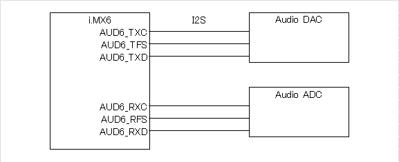

Hi community,
I have a question about i.MX6 audio connection.
I want to know whether i.MX6 can control if different devices (DAC & ADC) are connected to TX and RX of same I2S interface as attached image.
I think it is no-problem, right?

saurabh206
Senior Contributor III
Satoshi
It should work, but at a time only one device should be active, due to clocking issue.
If both device are used as a slave mode and operates on same frequency than it should work together.
Saurabh

igorpadykov
Hi Satoshi
you are right, this should be no problem.
igor
