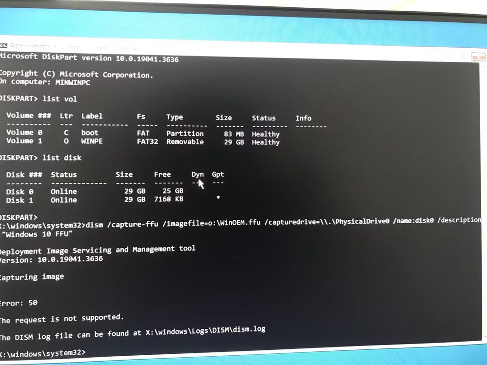

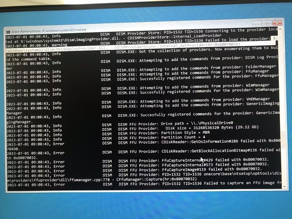

@Michal_Minarcik  Hello, I capture FFU using the command "DISM /capture-ffu /imagefile=x:\WinOEM.ffu /capturedrive=\\.\PhysicalDrive0 /name:disk0 /description:"Windows 10 FFU"" failed.

Michal_Minarcik
Hello @zhengyb9527,
What exactly was the command syntax for the Capture .FFU you were entering?
Just to clarify. "X" is the drive letter of the SD card or USB flash drive where the .FFU image will be stored. You can find out via Diskpart and the "list vol" command.
Michal

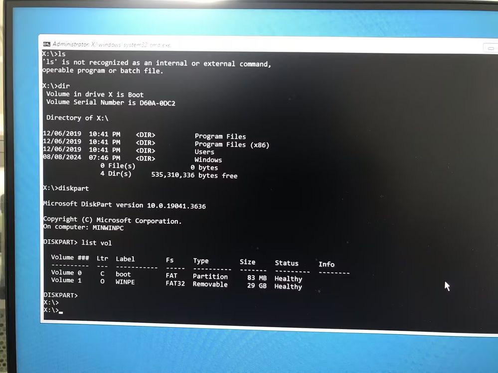

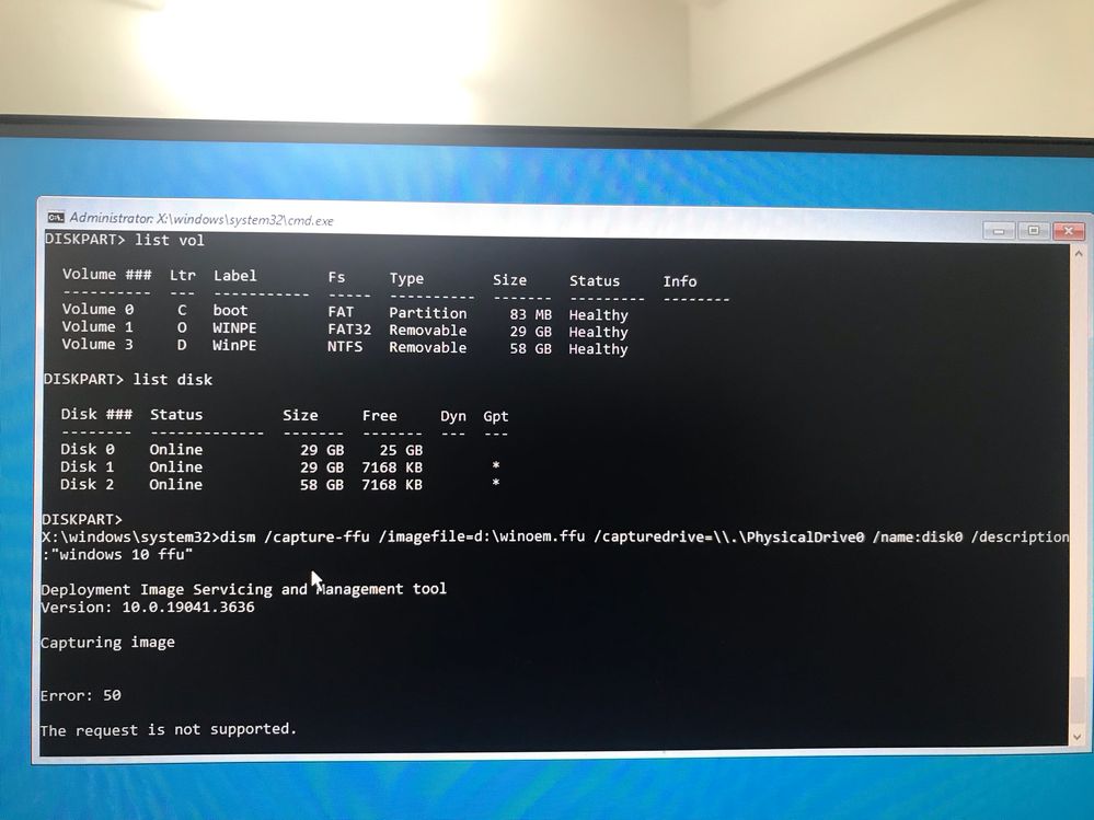

zhengyb9527
Hello @Michal_Minarcik , I can see the "X" drive letter in the cmd.exe.
9,724 Views
Michal_Minarcik
Hello @zhengyb9527,
Windows PE creates a temporary environment and it is often mapped to the "x" drive.E.g. If you would like to save the .FFU image to an SD card or USB Flash drive and you would list "list vol", it could be the letter "o:" as seen in your attached picture - if it is a storage, where do you want it. FFU image save. Otherwise, you need to connect another device for capturing.
Michal
9,697 Views

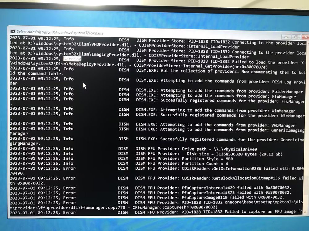

zhengyb9527
Hello @Michal_Minarcik I changed the letter "x" to "o", but the same error occurred.
9,675 Views
Michal_Minarcik
Hello @zhengyb9527,
In the attached image I see that there is Disk 0, which is the system you will want to do the Capture .FFU on. Next, there is Disk 1, which I assume is the SD card, which is FAT32 formatted and the .FFU image will not fit there (it's around 9GB). Therefore, it is necessary to connect another storage device (Disk 2) - a USB flash drive, on which I will perform .FFU capture.
Michal
9,625 Views
zhengyb9527
Hello @Michal_Minarcik  I have connected another usb flash drive with format "ntfs", but the errors are the same. may be the windos os that I used, it don't support dism captrue-ffu ?  the windows os is "en-us_windows_10_iot_enterprise_ltsc_2021_arm64_dvd_e8d4fc46.iso"

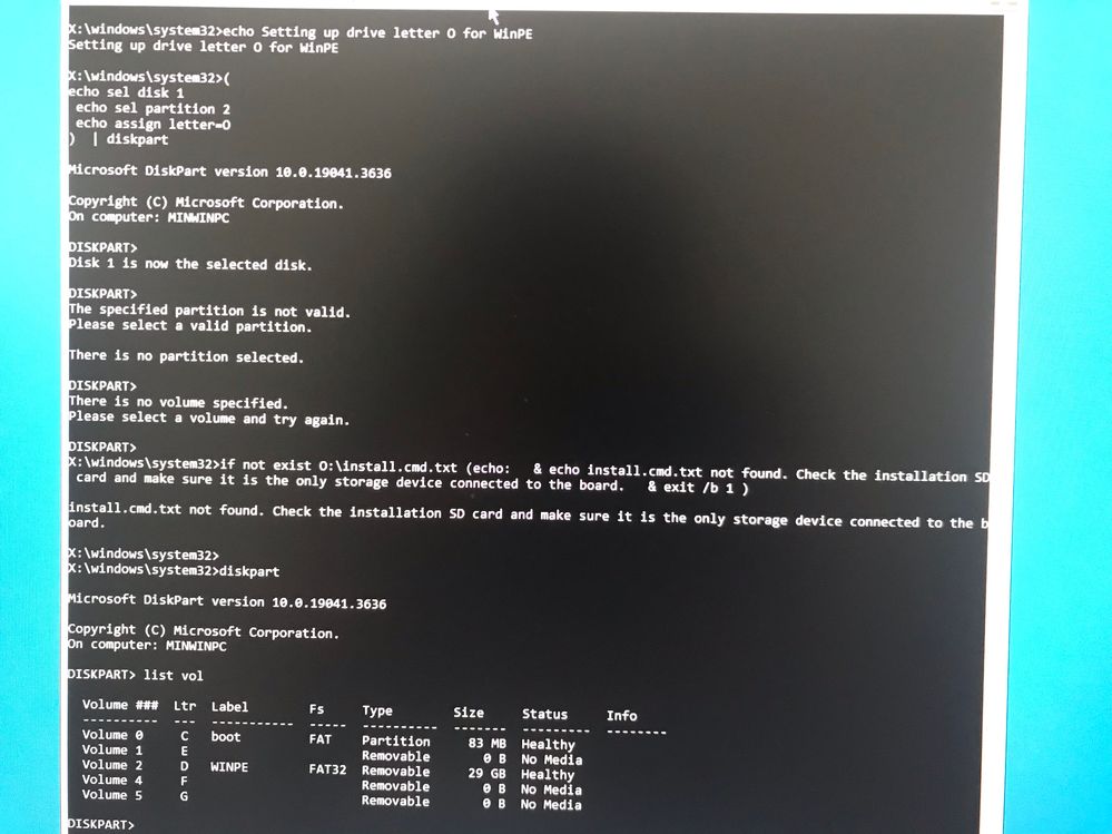

Michal_Minarcik
Hello @zhengyb9527,
Do you have a system already installed on the eMMC? Because the structure after the "list vol" command should look like in my attached picture.
We at NXP use a different Windows ISO image. Is yours listed downloaded from Microsoft?
Michal

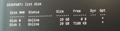

Michal_Minarcik
Hello @zhengyb9527,
Can you please send a screenshot when you are in Diskpart and enter list disk command?
If you have the option to install OS from the SD card, does the installation complete properly?
Michal
9,921 Views
zhengyb9527
i can install OS from the SD card complete properly, by the way i use the BSP 1.5.0, must it change to BSP 1.5.1? thank you.
9,911 Views
Michal_Minarcik
Hello @zhengyb9527,
It should also work in BSP 1.5.0. Do you have the possibility to try the installation in version 1.5.1? I can try more testing on the board until Monday when I'm in the office.

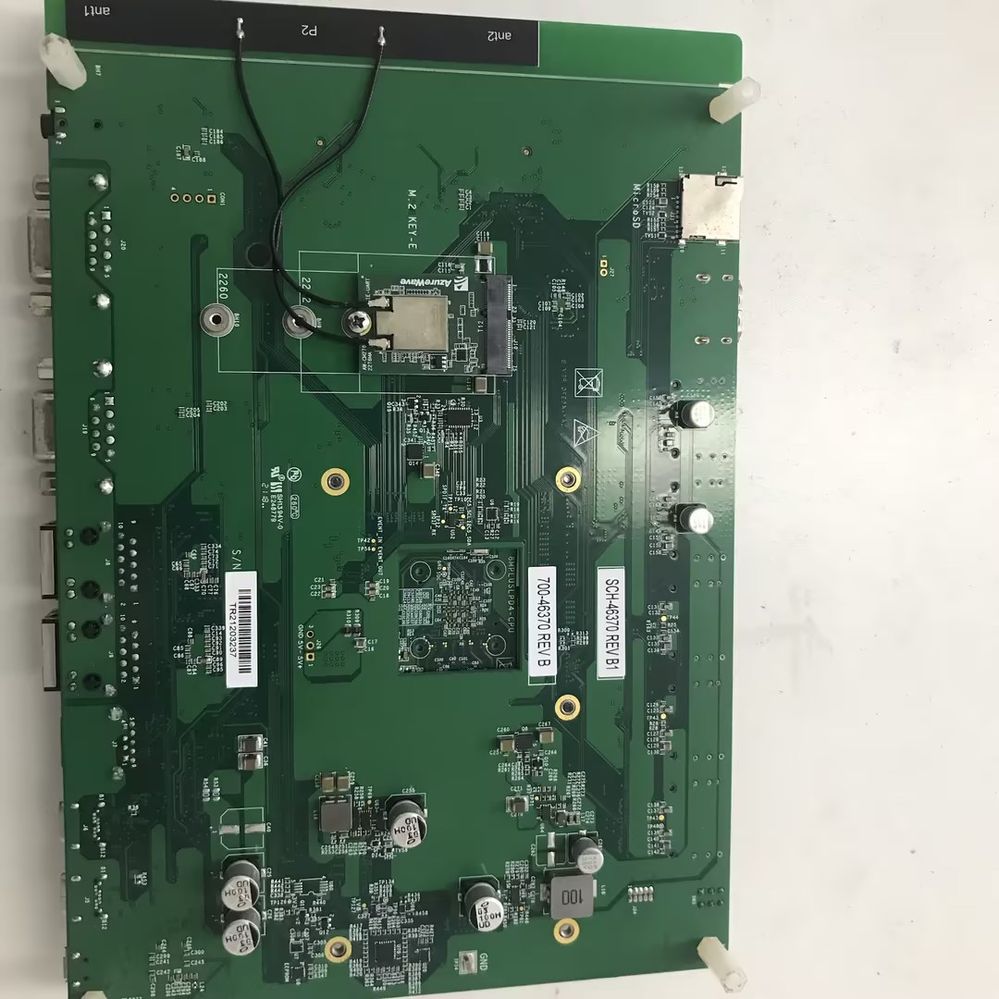

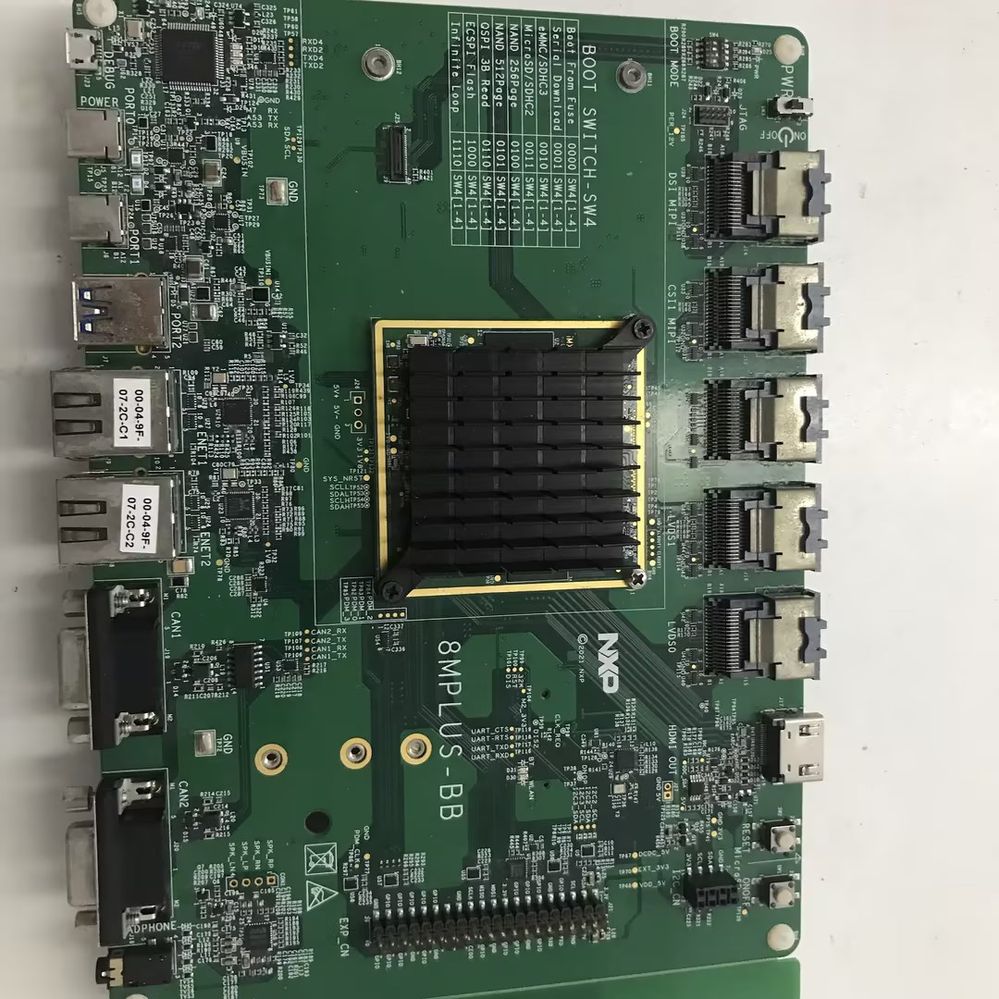

Based on my experience, the disk list in Diskpart should look like the attached image. So one drive is an eMMC on board and the other is an SD card/USB flash drive. Do you have another device connected there? Isn't it connected via some kind of reader that you can see more disks?
What board are you testing on? Please also send me the schematic version of the board you are testing on.
Michal
9,909 Views
zhengyb9527
I don't has a USB flash drive, so I use the usb SD card reader connect to 8MPULLS board.
