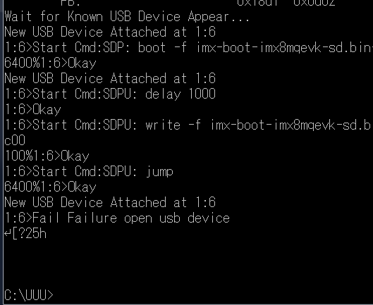

I am using the IMX8MQ  and want to flash images using the uuu utility.
If our usb0 only has usb otg without typeC controller, uuu tool can't flash our deivce
The error message as below:

Dear Charles Huang,
Did you have solved the problem?
Please share your solution if you have any solution.

charleshuang
Senior Contributor II
We have already remove this config (CONFIG_USB_TCPC) in u-boot,
but it's still not work.
It will stuck as below

传策薛
Contributor V
Windows环境你要装好驱动才行:
https://community.nxp.com/docs/DOC-342719
5,303 Views

joanxie
yes, imx8M board uses type C port to download image to board by UUU tools.
