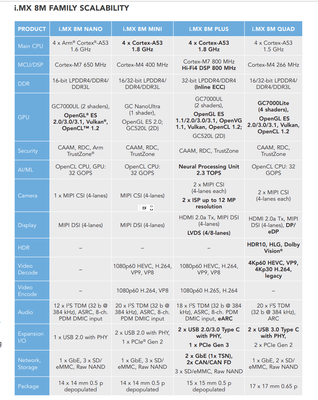

I made a imx8mp board which connected two max9286 camera deserial chips like imx8qm reference design.
Because i found imx8mp has two mipi csi2 interfaces and each has 4 vitual lanes as below picture description.
But i hasn't found any max9286 drivers and dts configuraton in linux kernel source by now.
Can anyone confirm if imx8mp can connect with 2 max9286 chips by csi2 virtual channel to realize 8 cameras usage ?
And if it is feasible how to realize ?
Thanks in advance!
TaoTao Wang

taotaowang
Hi, Chavira
Thanks for your response.
Would you please confirm that IMX8MP can connect 2 MAX9286 chips by the two MIPI CSI2 interfaces?
Can eight 1280*720 cameras solution  work for IMX8MP like IMX8QM reference design?
I found some previous posts described that IMX8MP can't support virtual channels.
If IMX8MP can't support virtual channels, the eight 720p cameras solution will not work, is it?
TaoTao Wang
