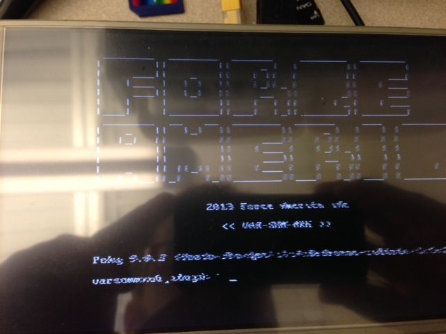

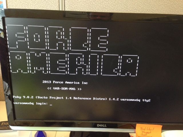

patrickmccleary
I've got the mirroring partially working. The HDMI video output looks good. The LVDS output is garbled. I believe this is due to the video modeline "800x480@30" in my bootargs which doesn't seem to be compatible with our LCD. If I use our display specific modeline ("VAR-WVGA"), I don't get any output from the HDMI connection.
HDMI Output:
LVDS Output:
Here is the setup that produces the images above:
bootargs:
console=ttymxc0,115200 video=mxcfb0:dev=hdmi,800x480M@30,if=RGB24 video=mxcfb1:dev=ldb

patrickmccleary
Any ideas on how to alleviate the garbled image on the LCD panel? I believe I need to use different modelines for HDMI and LVDS but I'm not sure how to do this.
