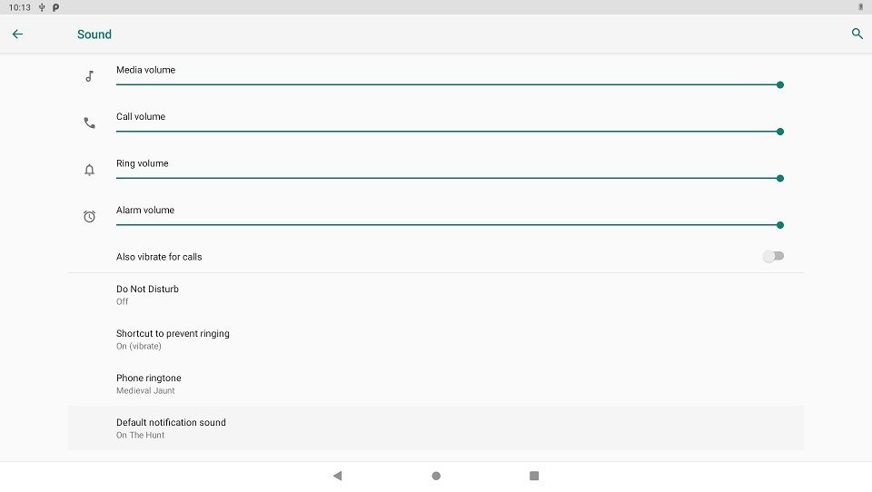

I flash the P9.0.0_2.3.0 Android image for MCIMX8M-EVK, and boot up with HDMI panel.
I want to change the HDMI volume in Android Sound settings, but the HDMI volume is not changed.
Like the graph below, I change the volume by scrolling "Media volume" bar, but HDMI volume always be the same.
I can change the default HDMI volume at here: android_source/frameworks/av/services/audiopolicy/config/default_volume_tables.xml
May I enable the HDMI volume change at android_source/frameworks/av/services/audiopolicy/config/audio_policy_volumes.xml?

Hi sinjhe,
     Google fixed the HDIM volume adjustment in the code, causing the HDMI volume to be either 0 or maximu
int mFixedVolumeDevices = AudioSystem.DEVICE_OUT_HDMI |
            AudioSystem.DEVICE_OUT_DGTL_DOCK_HEADSET |
            AudioSystem.DEVICE_OUT_ANLG_DOCK_HEADSET |
            AudioSystem.DEVICE_OUT_HDMI_ARC |
You can try to find a suitable position to add the line below to remove DEVICE_OUT_HDMI feature from mFixedVolumeDevices.
mFixedVolumeDevices &= ~AudioSystem.DEVICE_OUT_HDMI
File: ./services/core/java/com/android/server/audio/AudioService.java
[comment]
Here is just to provide you with an idea. If you still cannot achieve your goal, you can find a similar solution on the internet.
Have a nice day!
B.R,
Weidong

sinjhe
Hi Weidong,
Thank you, it works now.
