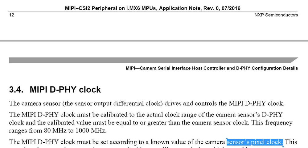

From the reference manual on "MIPI-CSI2 Peripheral on i.MX6 MPUs", AN5305 - MIPI CSI2, table 4 shows register values for... some clock - it's not specific.  The values are based on a ref_clock of 27MHz.  However, the default clock is 24 MHz for the YOCTO build.
How is the table generated?

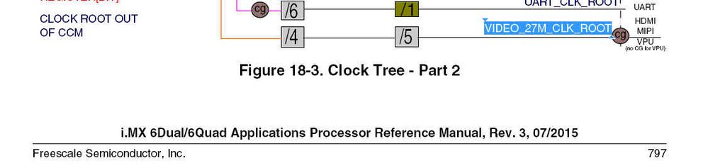

igorpadykov
Hi Nate
24MHz is crystal reference clock and other clocks (including 27MHz) are produced
by plls as described in Figure 18-2. Clock Tree i.MX6DQ Reference Manual
http://www.nxp.com/docs/en/reference-manual/IMX6DQRM.pdf
igor

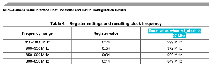

How are the register values calculated for MIPI_CSI_PHY_TST_CTRL1 ?  There is a nice table in both IMX6DQRM and AN5305 (table 4), but no explanation on how the table is calculated.  Could you help me with that?
12,861 Views
igorpadykov
one can also look at
Debug steps for customer MIPI sensor.docx
Table values are not calculated, seems they are provided by designers
based on modelling MIPI-CSI module.
igor

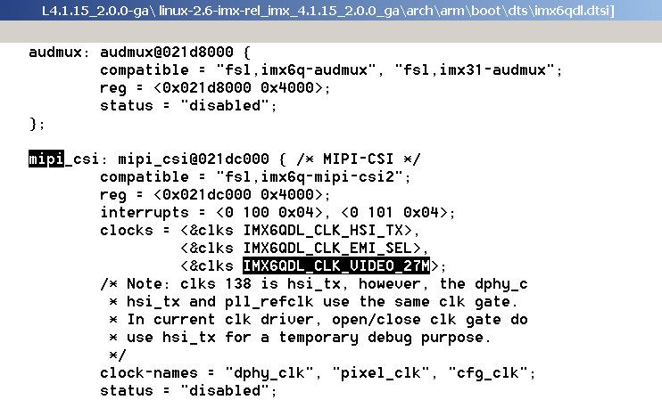

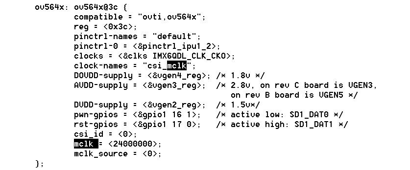

igorpadykov
there is no need for these changes as "video_27m" is already configured in dts
imx6qdl.dtsi\dts\boot\arm\arch - linux-imx - i.MX Linux kernel
probably there is confusion regarding "24MHz" as it is used only as reference clock for ov5640 sensor,
mclk in dts file. OV5640 uses it for own plls and produces pixel clock which then used in AN5305 calculations

natesigrist
Sorry but you English is too broken up.  The section you are pointing to is exactly what I'm trying to figure out.  Notice that in the following image that the ref_clock is set to 27MHz.  The actual clock is 24MHz.
How are these calculated?

igorpadykov
mipi pll_refclk can not be 24MHz by design, please refer to parts of i.MX6DQ Reference Manual, pll_refclk can be only 27MHz,
24MHz can not be sourced to mipi pll_refclk by design
igor
12,861 Views
natesigrist
Yes, I think you are right.  In my effort to be thorough, I got them confused.
At least in our application, speed is important.  I just needed to be certain that the details were right.  Thank you igorpadykov‌!
