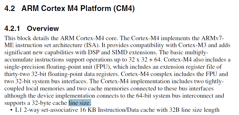

Could someone tell me the cache line size for A7 in i.MX7D ?
I read a reference manual and found only for M4.
Please tell me the size of cache line for A7 of i.MX7D.

Hello
  from the  ARM Information Center :
 * instruction side cache line length of 32-bytes ;
 * data side cache line length of 64-bytes.

Hello
Thank you for support.
I found it in technical reference manual too.
Cortex-A7 MPCore Revision: r0p3 Technical Reference Manual
L1: instruction side cache line length of 32-bytes
L2: fixed line length of 64 bytes
