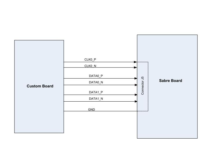

We made a custom i.MX6 board with a MIPI interface.
But, unfortunately we din't connect the resistor ( 6.04K) to CSI_REXT  pin.
Will the D-PHY of i.MX6 MIPI receiver be able to receive MIPI signals without this resistor being connected?
Is there anything we can try to receive MIPI signals other than a  board spin?
Thank you!

Hi Sonu
this resistor at CSI_REXT sets reference current for MIPI CSI
input circuits, it defines impedance characteristics given in sect.4.11.12
"MIPI D-PHY Timing Parameters" i.MX6DQ Reference Manual (rev.1  4/2013).
Without this resistor there will be mismatch of impedances and probably
MIPI interface will not work at all.
http://cache.freescale.com/files/32bit/doc/ref_manual/IMX6DQRM.pdf

I am trying to verify if concept is working with the help of sabre board.
We wired the MIPI lines from our custom board to sabre evaluation board as shown below.
Still evaluatiion board is not able to receive MIPI signals.
Unfortunately the PHY_STATUS registers value is 0x200, saying its not able to receive even clockl.
Is there anything fundamentally wrong with the setup?
Sonu

Hi Sonu
for MIPI sensor you can look at i.MX6 SDP schematic
it has OV5640 MIPI sensor on board
"MX6_SABRE_SDP_DESIGNFILES "
http://www.freescale.com/webapp/sps/site/prod_summary.jsp?code=RDIMX6SABREPLAT&fpsp=1&tab=Design_Too...
Regarding other problems - sorry, please create new thread.
