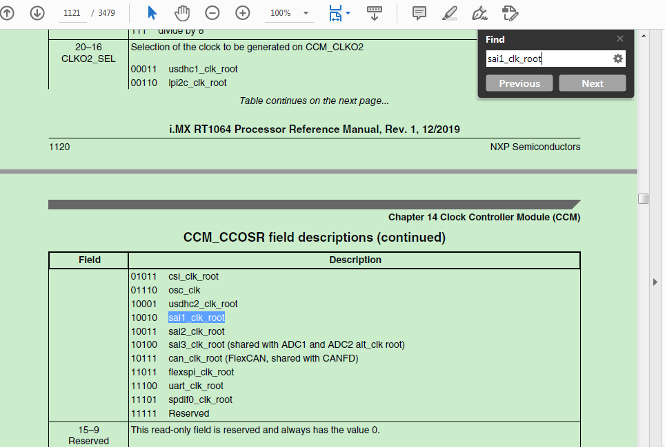

I am trying to output the clock of CCM_CLKO2 from GPIO_SD_B0_05 on i.MXRT1064.
I set pins and clocks in MCUXpresso Config Tool and implemented them, but I cannot observe the clocks from the pins.
Do I need to set anything other than the following?
pin_mux.c
IOMUXC_SetPinMux(
      IOMUXC_GPIO_SD_B0_05_CCM_CLKO2,         /* GPIO_SD_B0_05 is configured as CCM_CLKO2 */
      0U);                                                                        /* Software Input On Field: Input Path is determined by functionality */
clock_config.c
    /* Set clock out2 divider. */
    CCM->CCOSR = (CCM->CCOSR & (~CCM_CCOSR_CLKO2_DIV_MASK)) | CCM_CCOSR_CLKO2_DIV(2);
    /* Set clock out2 source. */
    CCM->CCOSR = (CCM->CCOSR & (~CCM_CCOSR_CLKO2_SEL_MASK)) | CCM_CCOSR_CLKO2_SEL(18);
    /* Enable clock out2. */
    CCM->CCOSR |= CCM_CCOSR_CLKO2_EN_MASK;
Any help is appreciated, thanks.

Hi T. Y.,

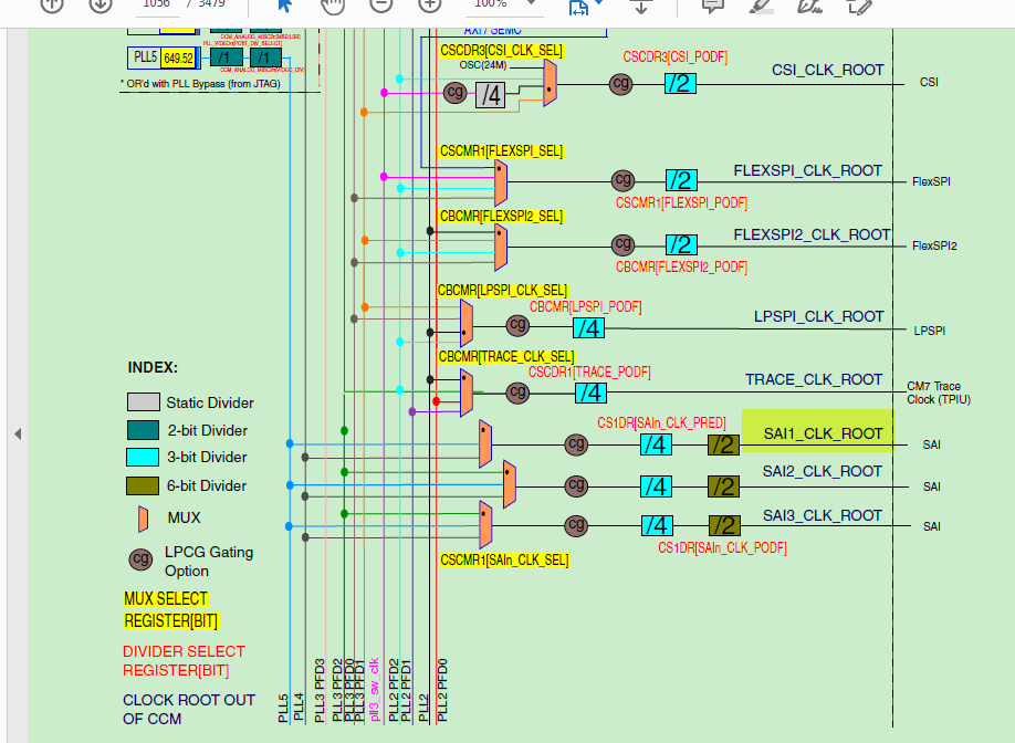

  Could you please tell me which detail clock you want to output in CCM_CLKO2 from GPIO_SD_B0_05?
  I find your code is choose the sai1_clk_root.
   Do you already enable the related clock?
  Please tell me which detail code you want to output, then I will also help you to test it.
Kerry

rileya53
Thanks, your guide. Really helped me.
Relevant clock was not enabled.
Waveform output came as expected;
Thanks.

yamakatb
Hi kerryzhou,
Thank you for helping me,
That is correct.
Did not enable the relevant clock.
Waveform came out as desired!
T.Y.
