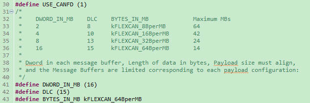

Hi I am trying to get the loopback_transfer example to work from the MCUXpresso SDK v2.7.0, which is the latest version now. It works with 8 byte messages so the CAN FD controller should not be faulty. I also tested it on a second dev kit which gives the same behavior.
I am failing to get 64 byte messages to work using the loopback_transfer example, I changed the CAN interface to 3 (which is the only CAN controller with CAN FD support):
#define EXAMPLE_CAN CAN3
I enable CAN FD using:
#define USE_CANFD (1)
I also changed the setting to 64 bytes per MB using:
#define BYTES_IN_MB (kFLEXCAN_64BperMB)
And specified the amount of DWords per MB which is 64/4=16
#define DWORD_IN_MB (16)
I also tried both:
mbConfig.format = kFLEXCAN_FrameFormatStandard;
txFrame.format = (uint8_t)kFLEXCAN_FrameFormatStandard;‍‍‍‍

I also tried to switch on the edl bit in the tx frame manually:
txFrame.edl = 1U;
All configurations led to the same output:

As you can see the first two DWORDS (8 bytes) are correct, so it seems that either 8 byte message buffers are used somehow even though I set it to 64 bytes, or normal CAN frames are used which have a maximum 8 byte payload but that shouldn't be the case as I explicitly set the edl flag of the txFrame to 1.
Either way I don't understand what I need to change in order to make it work or what I need to do to debug further. Is it possible to provide a working example that works straight out of the box? That would be much appreciated.

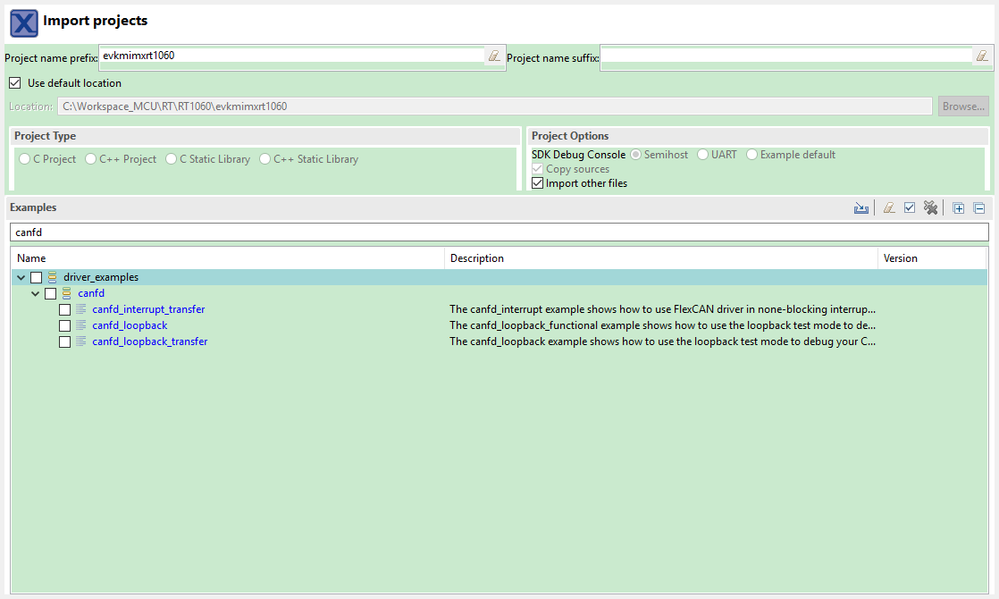

victorjimenez
Hi Jim,
Within the SDK for the RT1060-EVK you will find three CANFD examples. Within these three example projects, there's one loopback_transfer which works with a 64-byte payload. Please refer to this example instead of migrating a normal CAN example project.

jim_verheijde
Thanks Victor! I didn't realize there was a separate folder for CANFD, I thought everything was in flexcan as that is the name of the driver.
