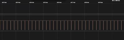

I'm using the MIMXRT1064CVJ5B custom board. To test the CAN-2 peripheral using MCUXpresso IDE auto-generated code. But when I'm checking data over CAN-TX of the microcontroller it's showing a high signal. Same code I tested in MIMXRT1064-EVK it's showing the correct CAN frame format.
For more details please check the below pics.
EVK board CAN TX data in logic analyzer:
Custom board CAN TX data in logic analyzer:
If anyone has any idea about this issue can you please help me to resolve it?
Nagesh

Yes, I'm able to run the "Hello World" example on the custom board.
I'm using the same configuration which I used for Evk. I'm using the MCUXpressoIDE_11.8.0 to generate code.
But not able to read the correct CAN frame in the case of the custom board.
Custom board CAN TX pin showing below data frame on the logic analyzer.

Thanks for help I changed baud rate to 500k previously It was 1M.
After changing baud rate to 500k I'm getting correct data. If I try baud rate more than 500k I'm not getting correct CAN frame.
Do you have any idea regarding this behavior?
