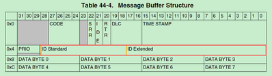

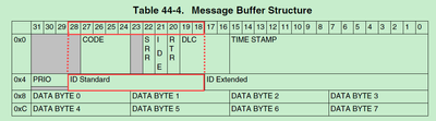

Hui_Ma
Due to you are using the CAN standard ID, which from bit [18:28], total 11 bits.
So you need to set FLEXCANx_RXMGMASK register bit [18:28] for related filter bit setting.
Please refer below picture for the detailed info:
Mike
